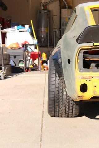

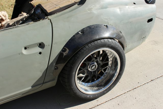

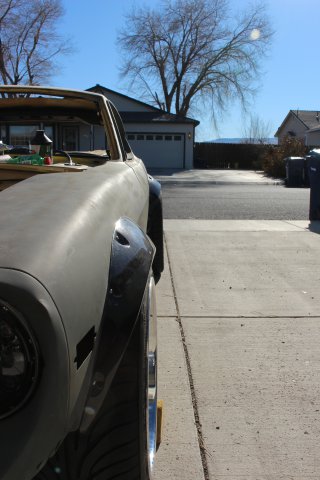

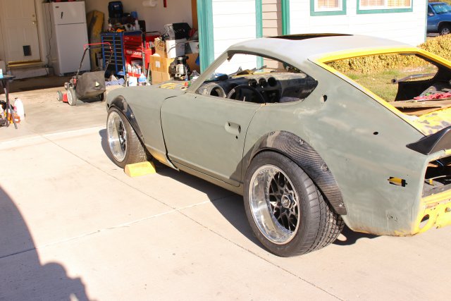

I was playing with the thought of running 315's on my car for the longest time so I went ahead and went for it I was getting tired of the stretched look and I wasn't about it. The fronts are 17x10.5 and the rears are 17x11.5 I posted this on Facebook groups but thought id post it here also.

That looks awesome! Holy heck that is a lot of tire. The fit is perfect for your setup. What arms are you using? Look like wheel center line is moved back slightly.
I am still on the stock arms trying to make up my mind on which to go with, I'm thinking about APEX engineering. I haven't adjusted the wheel center at all.

That's a really tight fit - does that tire really clear the flare on full bump?  Also, it sounds like you are already on it, but you're probably not going to want that much camber back there.  Make sure that the arms that you get will have enough inboard adjustment to allow you to pull the tire inward to get closer to zero camber - don't know about the two that you are looking at, but they are often more focused on increasing track width than reducing camber (most setups have more room to spare in the wheelwell than you are going to ;) ).  You're likely going to want to do the adjustment at the a-arm rather than via a camber plate,  since adjusting it at the top of the strut will push the tire even farther outboard.

yea im on it lol I wont be running this much camber I havent adjusted the camber on my coil overs and will be getting all the arms so will get a alignment when all installed lol its just sitting there I think it should clear full bump but we'll find out haha.
