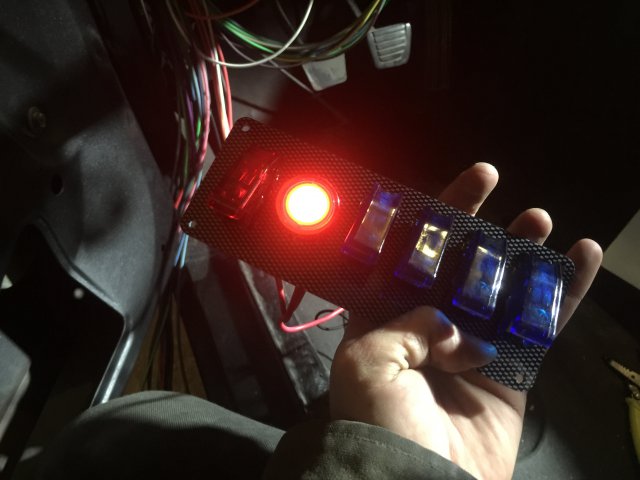

Hi all,
So I recently bought a toggle panel/push button start combo (here's the link: https://www.amazon.com/gp/product/B01JYRFLHG/ref=oh_aui_detailpage_o00_s00?ie=UTF8&psc=1). Pretty good build quality for the price, but I am rather uneducated when it comes to wiring. My goal is to be able to flip the first red switch and have that be my ACC power switch, then push the start button and off I go.
I ripped out the old harness entirely and have rewired the car with an EZ wiring 21 circuit kit. Currently, It's getting power to the button but it's not cranking over anything. Also, when I turn the ACC switch the power goes through to the button, but even when I turn off the switch the current continues to flow through, I'm assuming the relay is set up incorrectly. After having that problem I did some research and drew up this diagram of what I think would be what I want, but in the diagram, I have the ACC toggle on its own, whereas I want it to be in line with the power to the button if possible. The Toggles are 3 prong units, so I think it's possible? I am hoping somebody can look this over and give me some practical advice and tell me if I'm close, and if not, what I need to change up! Thanks in advance. Here are the photos/

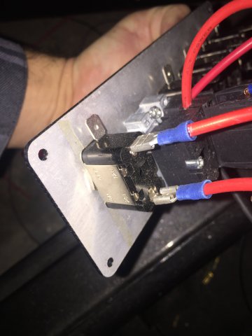

I think you're right. After going out last night and taking my time and figuring out what Namor was talking about his diagram began to make a lot more sense. I also tested my button to figure out what it's functions are. the bottom (so X3 and X4 on the diagram) are what has a power flow through it, but only when the button is pushed. X1 & X2 are on a separate circuit completely, and the only function for those two is to power up the button light (x1) and x2 is the ground. seem to be more so there for grounding purposes. Currently, I'm going to try and wire it up as his diagram suggest, but I don't have an ignition relay I don;t believes so I'm taking the first switch and having the power run through that as shown above, then the power goes to the button on x2, and I have the starter connected to that so it only gets power when pressed. The power then daisy chains from that port to the next switch that has constant voltage to my coil, brown ignition wire, and orange ACC wire. I have each of these grounded off wiht the third prong of each switch. It seems to be correct in my mind, they are each only getting the relayed power through them, not full voltage. except maybe that first main switch. rock on!
Share this post
Here is my current diagram based off of that I explained above. I tested it out last night, and though I've daisy chained from same screw ports I'm not getting constant power to the button/2nd switch, only when I press it down. The strange thing is that when using my Multimeter I am getting continuity throughout, at least while the battery is disconnected in the vehicle. My starter is still not going. I'll test the other end later to see if power is being supplied but It should be getting power. Upon researching my thoughts are because I used 87A on the relay, rather than 87 (87 normally open, 87a normally closed?) I'll try that as well and switch it. Strangely, I did a continuity test on my relay and didn't' get any continuity through 87, but 87a was fine, hence why I used that instead. I imagine it's so simple and my very limited understanding is laughable to people who know what the problem is ha.) I also am Pretty sure I need to have my coil on the constant switch, rather than with the starter?
Here are a few pics as well to show the situation and answer anybody else's question about the push start button if they were confused like myself.
