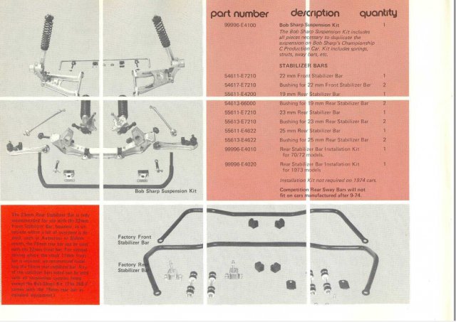

Does anyone know of a readily available 22mm sway bar that fits the S30?
I already have 18 mm, 20 mm, and 25.4 mm sway bars.  I currently have the 20 mm bar installed and would like to add a little more front roll stiffness without adding additional spring rate.  I know from previous use the 25.4 mm bar is too stiff for my needs.
