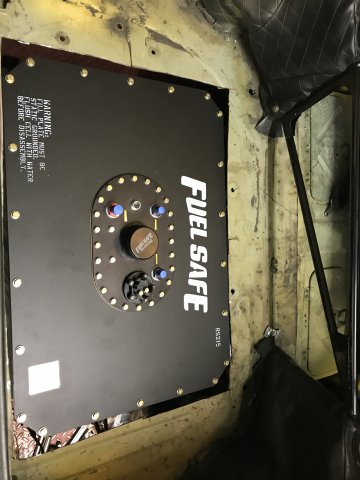

I'm curious to know why the fuel cell? Problem with the stock tank? Save weight? Certainly it will be less convenient when it come time to add gas to it. And this I know because I swapped one into an Alfa Romeo and had to pop the trunk, pull out any luggage if we were travelling, and then very carefully fill it. I had to lift the nozzle away carefully so that last drop didn't hit the outside of the tank or fall into the trunk and stink up the luggage. (I did it to save weight--and in fact stripped out almost 400 pounds from that tiny car. Made a nice difference at the track.)
This isn't idle curiosity. I want to consider the pros and cons, because I'm just getting started on a 280Z with a 350 and am firming up  plans for the project.
Share this post
The previous tank was a plastic jazz cell. Most of this cars time is spent on the track but it is tagged and insured. The plastic cell was always in the back of my mind.  Between  the cell and the cage for the cell,  I’m sure this set up weighs more than the stock tank. If this car was primarily a street car I would have left the stock tank.

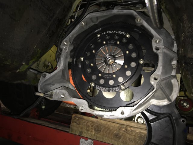

But, the "Hardened Hub" disks look like this, each friction has it's own splined hub:
The "Gear Drive" disks look like this, where there is one larger hub and the 2nd friction rides on that:
img_6287_zpsf3497a02-jpg.245491
I had the 6 leg 7.25" V-Drive clutch in the Evo I had for ~40k miles.  I went through a set of hardened hub discs every 8-10k or so, while the gear drive lasted a bit longer. That car made 897hp/715tq to the tires and the clutch held fine.
There is certainly a learning curve to that clutch and the hydraulic TOB, especially with the race compound friction discs.
