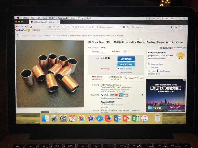

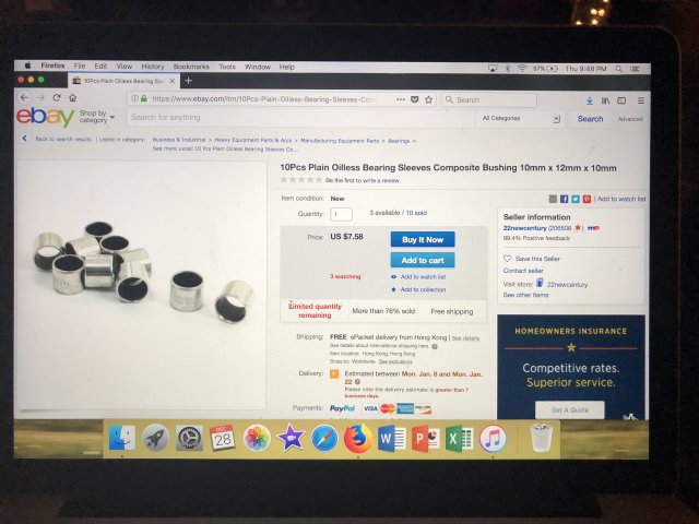

On my list to accomplish is 2018 is to install a 3.36 CLSD R200 into my Z. I have not torn into my 3.36 R200, but I am lead to believe that it will have I may have an issue with ring gear bolt incompatibility with my Z31 LSD carrier. I searched the FAQs on this issue and there were references to 10mm ID/12 mm OD spacers being available on McMaster Carr’s website. Well, I couldn’t find any. So, I turned to eBay and found some that so will try to use. I lost this only as a search reference for the next guy doing this modification.

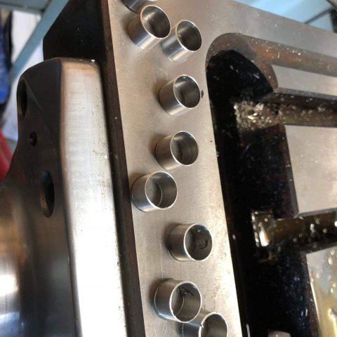

I’m having a vlsd installed in a 3.7 z31 case. The vlsd I bought was supposed to have 12mm bolts based upon what the internet says... which is always right...
The 3.7 ring did have 12mm bolts. To take up some of the space, my fabricator turned some bushings to press in.
There were no 12 x 13 units available on eBay, so you’re lucky with the 10x12.
