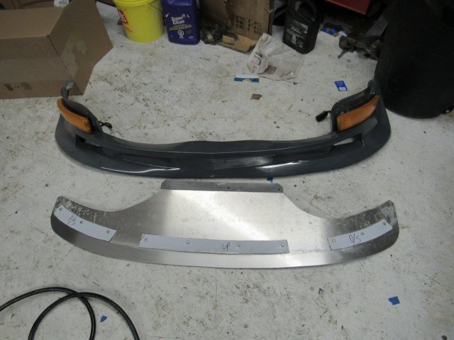

Trackzpeed, I like what you did there, attaching the support where you did keeps that top piece from warping, I made my support into a splitter , without some kind of support that urethane air dam is useless.
