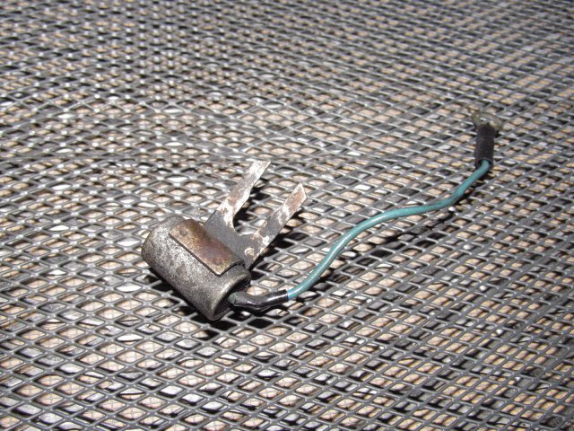

Did you see my E-Mail that I sent the other day, regarding the EMI suppression capacitor that must be attached to the +12 V terminal on the alternator?  It is to reduce electrical noise.

I have done all that your talking about. I moved o2 ground to intake on its own stud. There is a condenser on the alternator. I added a new ground strap from alternator. I put a capacitor inline to try to silence noise. Nothing worked.. only unplugging the alternator. I did notice that this is not very uncommon and I am only having issue with my o2 sensor. Nothing else is being affected. I will try moving my ms2 mounting position and see if that makes a difference but if not I am going to just adjust the afr voltage in tuner studio to match the gauge. I have done that now, but don't like masking a known problem.
