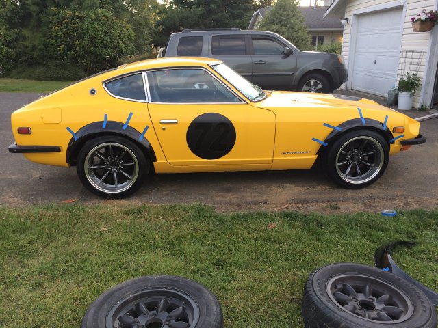

As an aside, your rear flare looks to be a bit on the low side? That is if they are ZG flares, the ends look like they are sharper than normal though.

Like wheel alignment or flare alignment? There isn't any adjustment in the rear for wheel alignment from factory, so if the alignment is out of wack and it is not due to a bent wheel or stub axle (verified via checking flatness during rotation), then most likely someone bent the control arms or the control arms are loose/missing parts of the bushing. If nothing seems bent and it it is still out of alignment you can either take the chassis to get aligned on a rack, or you can buy some adjustable rear control arms to compensate if it is minor.
With a turbo 2j the Z is more than fast enough. Nothing is too hard to work on or order replacement parts which is why I went this route. Car handles pretty nicely, but it is on coilovers and adjustable tubular control arms with heim joints and poly bushings all around.
