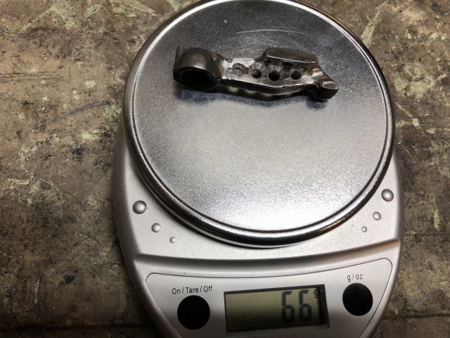

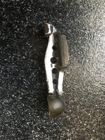

23 hours ago, motorsci said:
This is a old rocker Iam lightening has any one else done this ? It's 10 grams lighter it's not a finished product I just started

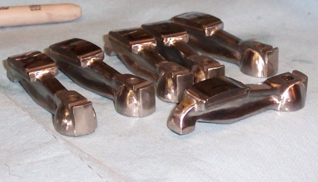

I did something more like this:

^ That looks a lot safer than drilling holes and creasting stress risers. You're actually removing stress risers by polishing. Not that I've ever seen a stock Nissan rocker break in two. The " Forge " be strong with these.
Yeah I had some time on my hands while the block was at the machine shop :mrgreen:
I'd be a bit leery about drilling holes too - these rockers also weighed significantly less (don't remember the amount offhand - it was several years ago) and have had no issues whatsoever.  To Chickenman's point, I also paid a lot of attention to details like eliminating potential stress risers, trying to get the direction of grinding/polishing aligned down the length of the part, and spent a lot of time polishing them.  Those took me roughly 8 hours each to complete.

It's not really for the hell of it but for manufacturability, i.e. at some point you're adding steps and time to your process for diminishing returns. They can be further optimized for specific applications, as Tim has done. Doesn't mean that the Nissan engineers purposely threw more weight on them, nor does it mean that Tim necessarily knows something the engineers didn't. It's all a matter of application.
I also don't see a great case for a broken rocker destroying pistons or the valvetrian. You can nick a cam lobe maybe. E30s break rockers on track all the time, swap the offending rocker and off you go.

As i said it was several years ago and I don't remember the exact amount.  There was a significant amount of material removed, though.
I went and found the thread where we were discussing this at the time and it appears it was on the order of 3 grams/rocker:

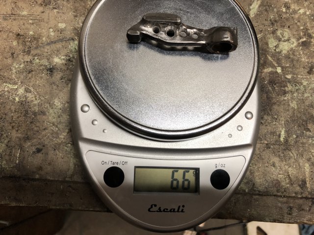

Thank you all for your input I have titanium retainers locks and DSI valves from Datsun spirt I have a good unmolested. Set of rockers to put in but just enjoying a little time off work and waiting for the machine shop have a press with a tension gauge and was going to make a fixture to measure the deflection at the tip and what it takes to break it compared to a stock rocker here is a pic it ready to polish 66 grams
