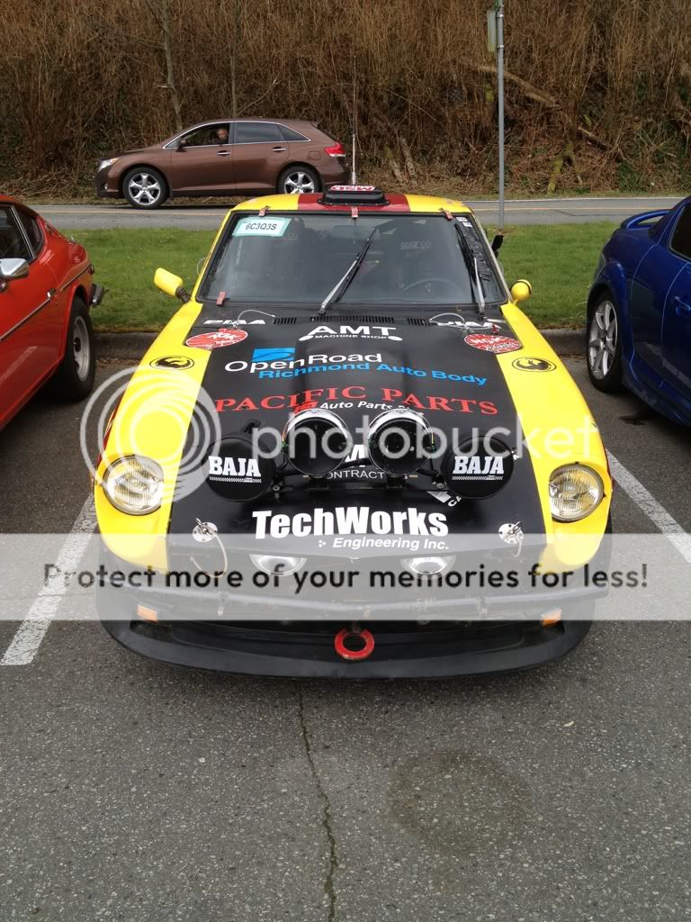

John Coffey built this one a few years ago. Unfortunately he died in a motorcycle wreck. Real loss for the Z community. I think he had some posts here about it, but my impression was that the biggest change was some custom long travel Bilstein struts. Had a pretty beefy skid plate and push bar, and the roof rack. I haven't talked to the owners of the car, but they don't seem like the secretive type and would probably answer questions you might have.  https://www.facebook.com/p2p240z/

I had a short conversation with T3 and they have done a rally setup using bilstein cartridges for a client in the UK. Also stated their existing arms offered enough adjustment to account for camber with the lift. Sent Carl an email regarding info on what the factory cars may have been using.
