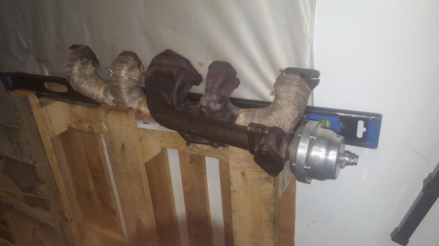

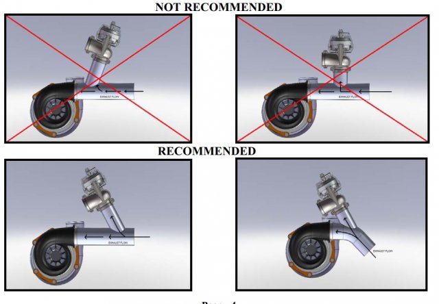

Can you post up a wide angle shot of your W/gate manifold and exhaust setup?  Proper angles of W/Gate inlet pipes and outlet pipes can make a huge difference to W/gate efficiency as noted above. Right angles and reverse angles are bad.
Edited by Chickenman

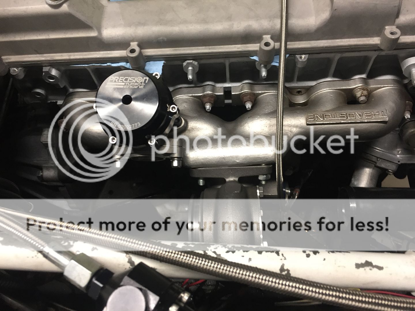

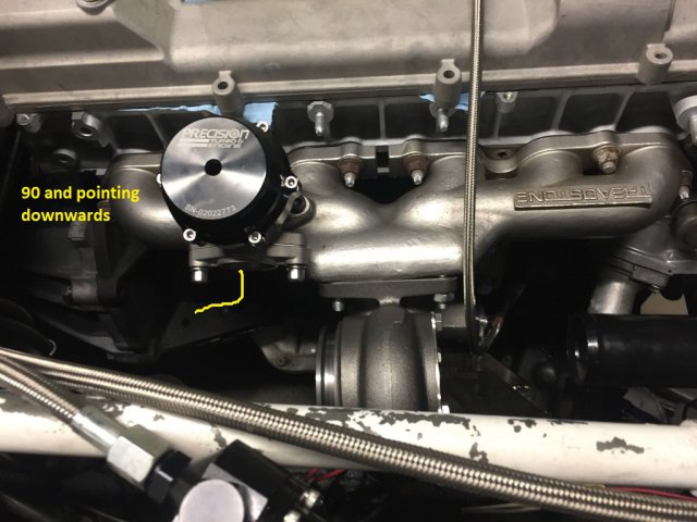

Thank you guys for the response, I must have missed them.
I'll grab a wide angle shot this weekend.
A8D4168B-412E-4A47-BB46-5BED80A65165_zps
That is where the wastegate is mounted.
49DA4631-3D32-4EEF-B4F0-5E4B08B976D6_zps
That is unfortunately how the wastegate dump merges back with the exhaust, it is probably one of the worst ways of merging to be honest. I tried to tilt it so it is not perpendicular, but I couldn't get it very far from what I recall. There just is not very much room unless I try to do a full 90* turn and follow the exhaust for a little bit, but then I run into interference with the heater bypass hose if memory serves.
I might believe that the wastegate was opening plus or minus 3lbs of the rated spring, but I've been told precision gate springs are pretty solid. Swapping the springs doesn't cost me anything though, so I will give that a try.

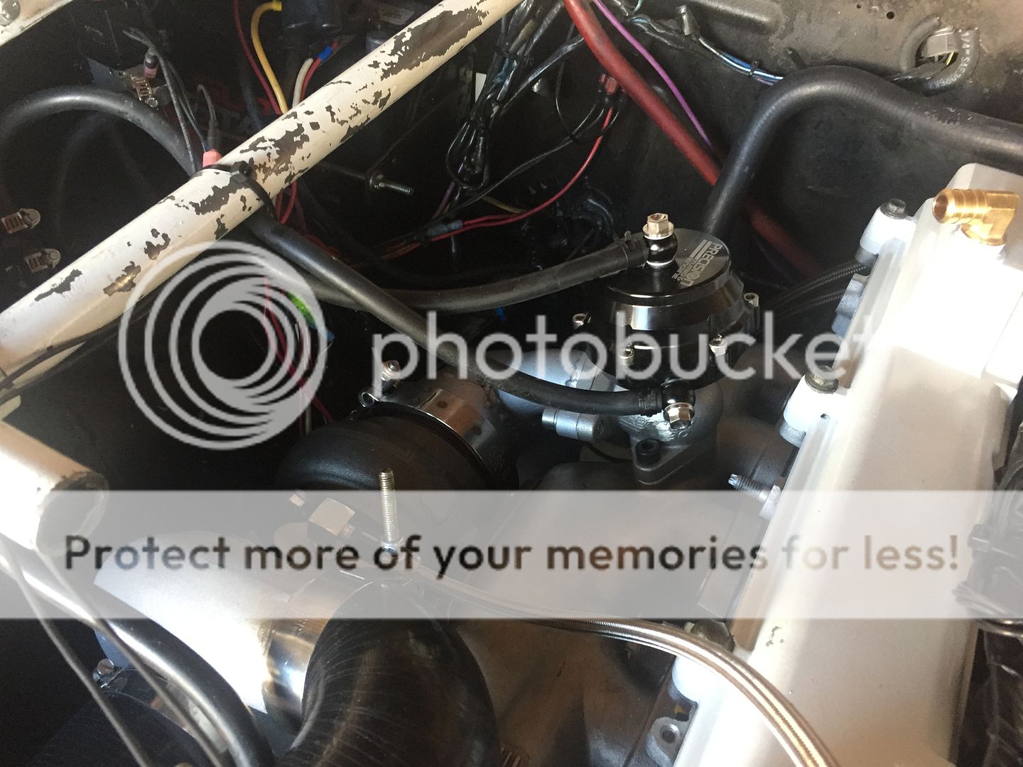

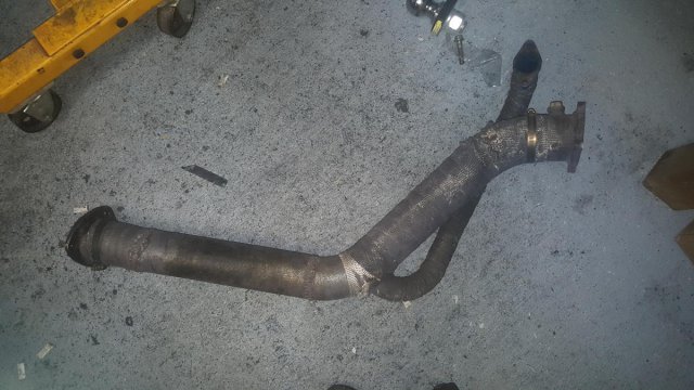

Edit: found another picture.
C1BC9952-5985-4D42-BBDB-E03CF49DF643_zps
Looking at that seems to have jogged my memory. I seem to recall that the 90* bend actually hit the turbo dump pipe when it was turned to follow along with it. So short of resorting to pie cuts for a really sharp 90*, this was the only option I had. I can try a screamer pipe setup, but I fear that the only way to do so would be to go up through the hood because of the previously stated interference. I'll go and take some measurements this weekend.

Yeah... I can already see what is probably the Major problem. The manifold design. That is a worst case scenario for W/Gate placement on both the W/G inlet and outlet.
Inlet is 90 degrees and only bleeds 3 cylinders, if that.  The manifold looks like it's possibly a Twin scroll design. Is it? Either way, it;s going to be hard to bleed off enough pressure with that exhaust manifold W/Gate positioning.
On the outlet side it is worst case scenario as well. 90 degree exit into the high pressure area of the Turbine outlet. If you could re-route the Dump pipe, that would help a lot. Length doesn't really matter. You could route it another 2 or 3 feet further along the exhaust system, then blend it in at a nice angle.
Problem is just getting it past firewall.  With a long W/Gate dump pipe, you may want to run an  accordion style expanding bellows, as the dump pipe will expand in length a fair bit.
Things like ovalised SS tubing may help. Or using a 90 degree adapter, so W/Gate exit is towards firewall, then run dump pipe behind exhaust manifold, beside the downpipe and Transmission? It looks like you may have enough room to do that?

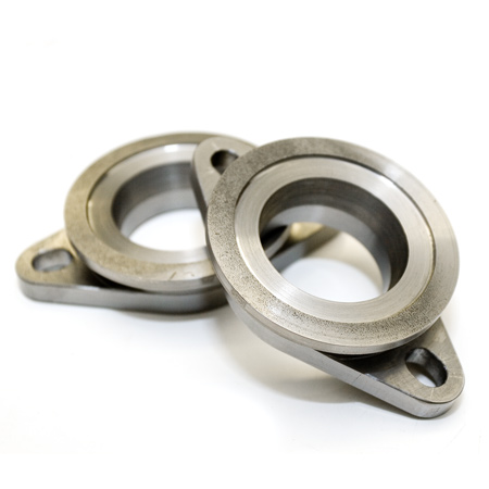

Would have been nice if the exhaust manifold came with a V-Band adapter. Would open up options for W/gate clocking.
This is what I was thinking about for a 90 degree adapter.
https://www.atpturbo.com/mm5/merchant.mvc?Screen=PROD&Store_Code=tp&Product_Code=ATP-FLS-025&Category_Code=WGEL
Or is you want to switch to a V-Band mount W/Gate.
https://www.atpturbo.com/mm5/merchant.mvc?Screen=PROD&Store_Code=tp&Product_Code=ATP-FLS-101&Category_Code=WGEL

The waste gate adapter did catch my eye for stepping up to a 44mm and getting the infinite clock-ability of the V-band. I think the concern with that style is that the hole still remains at 35mm according to some diagrams online. That would mean needing to port the adapter and might as well the manifold, and if that is the case might as well just weld the included wastegate flange from a 44mm wastegate directly to the manifold after porting it to match was my thinking. Not even sure how you port cast stainless. Only thing that was worked before was tungsten carbide bit on a dremel and that took ages just to do a couple mm on a flange.

I think my endgame plan will be picking up the precision 46mm wastegate, match the flange to the V-band, then clock the waste gate so that the pipe goes out and enters the dump pipe at a 90 degree to the turbo exit (follows the bend of the dump pipe), so that it goes along the curve and gradually blends into taking maybe 3-4 inches to do so.

Before moving the wastegate entirely or rerouting the dump longer try buying those flexible dump pipes and essentially a screamer pipe.
https://www.ebay.com/itm/35mm-38mm-Wastegate-Flex-SS-Dump-Pipe-Kit-Stainless-Steel-weld-flange-Gaskets/173209341778?hash=item285414cf52:g:zp4AAOxy4YdTTWPX&vxp=mtr
Your piping looks too short right off the bat I am suprised with this treadstone design honestly its off center and the angle is not optimal. If you do eventually do re route your dump further into downpipe with non flexible joints you should put atleast a flex joint / expansion joint.

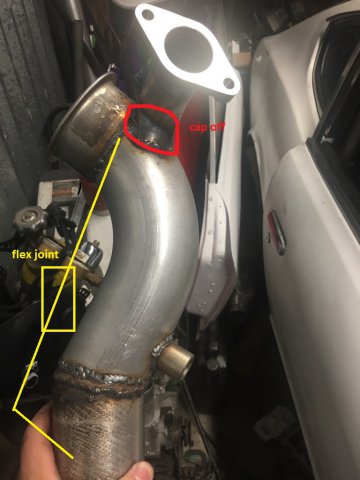

Yes cut off , cap it (* you dont have to weld it maybe some thin sheet metal clamped down with some tbolt clamps just to test the theory . The reason I suggest this maybe so you dont spend more on a complete redesign of manifold, wastegate, and downpipe.
I have seen many adapters that do the wastegate's off at 90 some people do have issues with compressor surge and boost problems but not every setup is the same. Also at the same time lots of people do run it with no issues.  I didnt know till last summer street racing a 700hp DSM he had a flex dump. I dont think the quality is the best to be honest. However, I suggested this to troubleshoot and quickly see if the issue is your dump being to short * which I think it is * . OR if the issue is the wastegate angle which probably could be combination of both.
How flexible it is I dont know. But I do have a similar stainless steel flex tub for my radiator piping and you can make a decent tight radius but Yours looks super tight.
Share this post
Posted (edited)
If you dont want to spend the money with the flex tube I would go straight ahead and modify that dump , Make a tighter radius fit it between manifold and downpipe and have it merge into downpipe with flex  or dump it to atmosphere. Even if it doesnt solve your issue its still more
* optimal
* have to worry about thermal expansion cracking/distorting your exhaust setup
edit also if you need more room what about a spacer at turbo a halft inch just at turbo would do wonders down stream.
attached is how I would do it.
