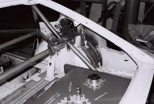

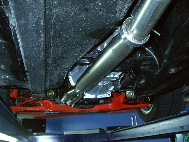

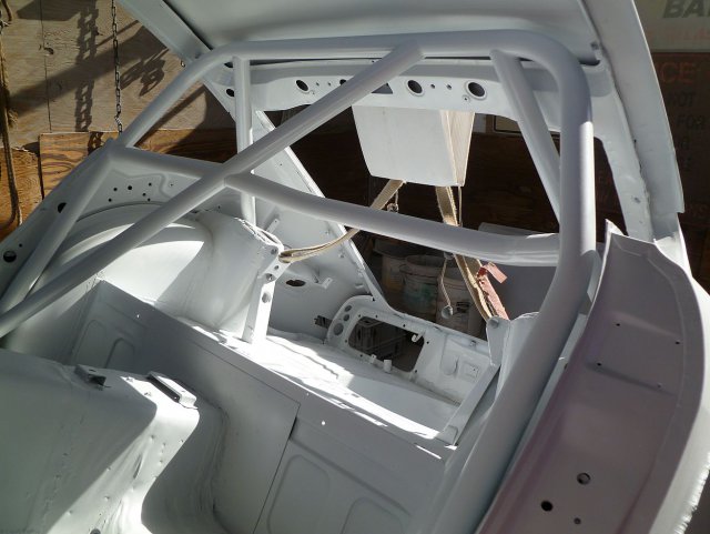

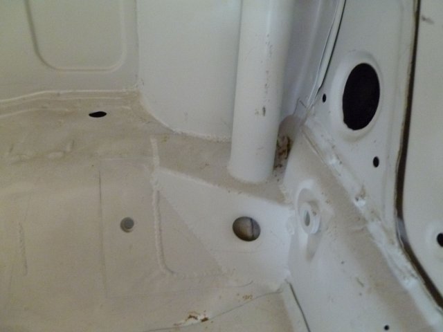

for a street car these few pics should give you an idea of what I have on my two street cars and I feel that this is ideal for chases stiffness without the wasted space and issues bars for a street car.  I can jack the car up with a jack stand and have three wheels off the ground; it give me the stiffness of my crazy Primadonna Z car with a 9 point cage so for street use I think this is ideal.  If you worry about rolling the car you can add a basic hoop but no need to do the rest of the roll bar work for street as that just becomes a pain for anyone else you give a ride to, as they will not like the bars interfering with easy entry in the car, etc.  Believe me very few women want to ride in a car that is too caged.  This boxing of the frame rails goes from the front all the way to the rear sub frame and is boxed inside as well.  It follows the factory fake rails and give is true strength of a framed car or a Z with a cage without the bars in the way for a street car.  Unless you really want to compete for a track I think this is way better.

Link to AU regs which show variations of designs using self explanatory sketches, a handy design reference  http://docs.cams.com.au/Manual/GeneralRequirements/2018 Edition/GQ11-Schedule J-2018-1.pdf  As Jon has mentioned this is the time to consider structural aims, from my observations this is often neglected. The priority, tag the cage to the body wherever possible which requires the builder to keep the bars close to the body which some of them don't like because it makes their job harder. In particular keep the A pillar bar snug, the common idea of having a big plate with lots of 'structural' flanged holes spaced away from the pillar gets me, other than looking fancy it's nonsense from a driver visibility and a structural point of view.

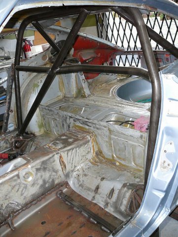

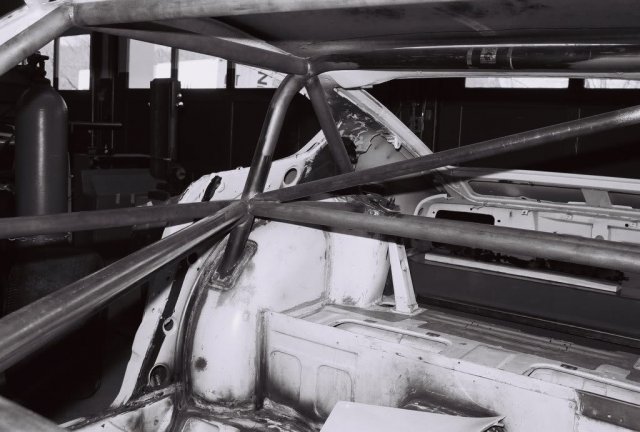

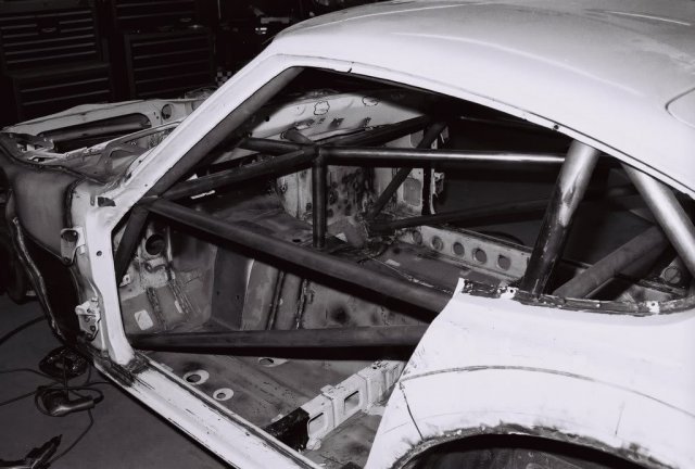

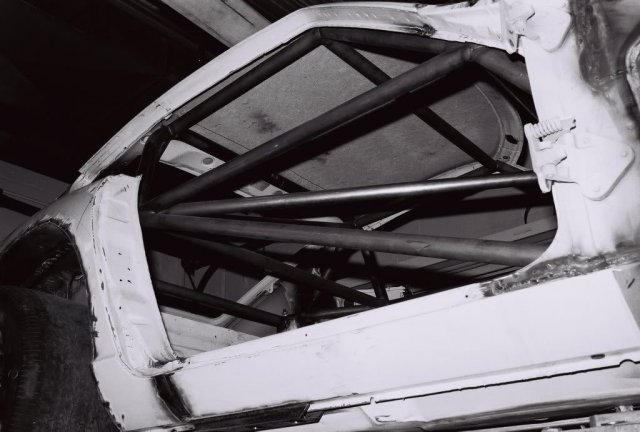

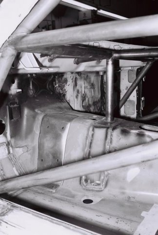

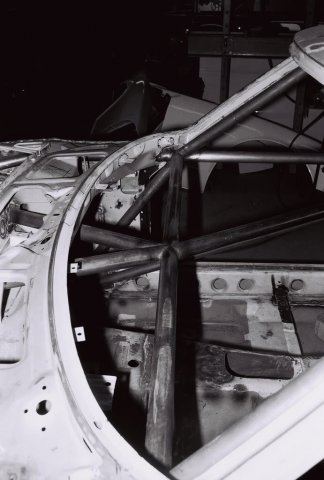

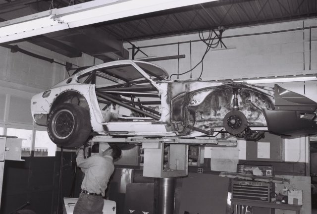

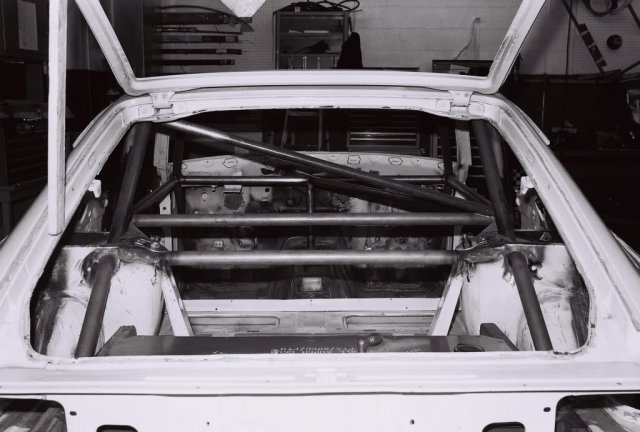

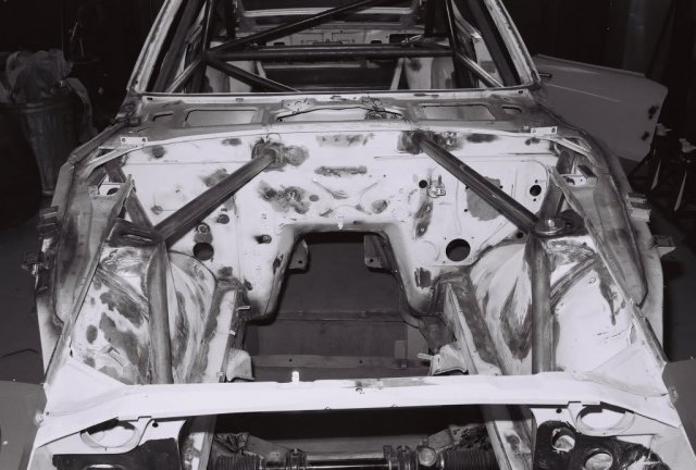

If your serious about a full cage go old school, vintage BSR-260Z-IMSA design.  Since my 280Z will be street driven like the OP's car I will most likely build something similar to Dan's Street Cage design.
Love these old photos.

Interesting on the old photos of the full race cage how the main hoop anchors to the front edge of the rear fender well instead of to the floor just in front.  Is it as strong or effective?  If so, that is ideal for accommodating factory seatbelts for a street legal car, as well as potentially more room for taller drivers.
Share this post
That's similar to how the Autopower bars attach. They used to be SCCA legal. Not sure if they are anymore. I do think it's a LOT better for seat clearance, but it's very hard to connect door bars to. I haven't seen one of their bolt in cages in a really long time, but I seem to recall they had one door bar that clamped to the roll bar then bent down in front of the door and went forward to the A pillar. I don't think the door bar bent into the door area and I think it was only a single door bar.
