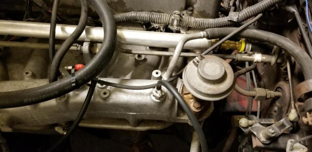

Hi all, I just joined the forums. I bought a 77 280z a couple of days ago and I'm having trouble passing emissions. The previous owner installed a megasquirt EFI which wasn't really the issue during the test. However, some vacuum lines are missing.
The EGR valve isn't connected to anything and the vacuum line diagram shows that I must have a BPT valve, which I don't. Would it be ok if I connect the EGR valve directly to the intake manifold?
EGR valve photo

Sounds like they actually do some inspection up there. Here they just look under the hood to make sure you have an engine. My EGR and evap were completely disconnected just like yours. If you just want to pass, I think you can just plug the egr valve into any port on the intake manifold and follow the diagram for the evap can. I'm not really sure about the "BPT valve." I'm pretty sure it has something to do with when EGR kicks in, but I don't know if it will have a negative effect on performance or emissions, but it'll probably get you past the visual just like that.
Share this post
I spent all night researching this, apparently the BPT valve controls how much vacuum the EGR valve receives, if I connect it to the intake manifold directly I guess the EGR will stay open. I dont know if that will affect the engine performance in a any way but if it gets me through emissions, i'm willing to try I guess.
Share this post
Where?
Share this post
I'm assuming the thermal vacuum valve is the one with the red cap in this photo5ab4105e4ca03_1521690878639664280807_1521690898891(1).thumb.jpg.3c85934ff3b90e5be3be0922d5833d94.jpg
if I bypass the BPT valve the the EGR valve will actually stay closed. since there's no BPT valve therefore it's technically always "open".
Anyways I'm just spitballing here. I'm probably gonna delete the EGR after I pass emissions, so I just need it to look like it works and not do any damage in the process.
