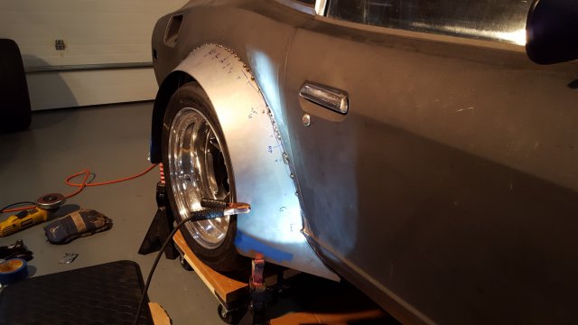

I have a set going on a 240Z.  The rears are tacked on and I'm working on the front now.  They are plenty stout, and laser cut, so each set has the same shape.  They do ship flat, but forming them is simple.  The rear flares I left at full width and they line up well with my 315 tires.  Up front I have 275's, so I used metal shears and took 1 1/4" off the top radius.
They did mistakenly ship me 350Z flares the first time, so I have those collecting dust if you're interested in them.

Those look better than the other add on flares I've seen. Not as traditional but that's not necessarily a bad thing. Does the lip roll over or just metal edge on the outer? How does that stagger work in handling? I'm starting to worry I may have too much and the car will push in the front. Planning a little narrower than you list here but similar 40mm difference.
Share this post
The more i see them the more I like the look. I to would like to know how you finished the edge. I have heard of people welding a very small pipe on the outer edge to finish custom flairs but would like to see what you have planned.
Also, how are you tying it into the airdam.
