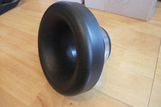

I think bigger is better until a certain point where it is adequately large enough and won't make a difference.  A bigger filter might perform longer before needing cleaned/replaced?
The guys on Engine Masters tested all kinds of air filters and what they found in a different scenario (domestic v8 with a carb) is that the turbulence in the filter has more effect on performance than anything. They found that a funnel or bowl shaped (velocity stack type) shape really helped performance.  It is an interesting watch: https://www.youtube.com/watch?v=EkpsydS8JXI
Share this post
Interestingly NA's actually requite larger filters than force fed motors. I had a table listing what minimum size your filter needed to be for a given hp for both NA and turbo engines, I will post it if I can find it.
If you can fit a filter with a v stack it makes a big difference.

Or this one which has the shape that @EF Ian was talking about but is a bit smaller (5 1/2" height vs 8" height): https://www.aemintakes.com/search/product.aspx?Prod=21-203D-XK
Do you guys think #1 or #2 would be better? My only concern about #2 is that it is too small for some reason, but it may let in more airflow than #1 because of the space on top. Or am I just better served getting something else entirely? e.g. like this generic fleaBay filter

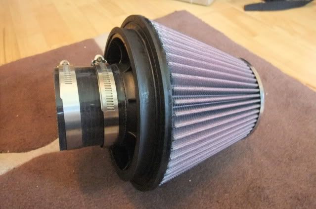

Decided to go with Amsoil's EaAU3090 filter which competes against K&N RE-0810    . This is just an inch larger than my current one but also has the "V-stack" concept that EF Ian mentioned so it should have more than enough surface area/airflow.
Amsoil:AMSOIL Ea Universal Air Induction Filters: AMSOIL Universal Air Induction Filter: 1 FILTER Product ImageK&N:RE-0810_Alt.jpg
I figure if it is too big, what is the worse that could happen? Will it run too lean? Just seems like the extra space will make it last longer before cleaning...

Welp, regardless, it's too late now. It barely fit. I had to remove my oil cooler from it's mount to put it on.
I'd say "For the next one, I'll go back to the smaller size" but given that this car will be driven ~2000 miles per year, I couldn't tell ya if there will even be a next one...
