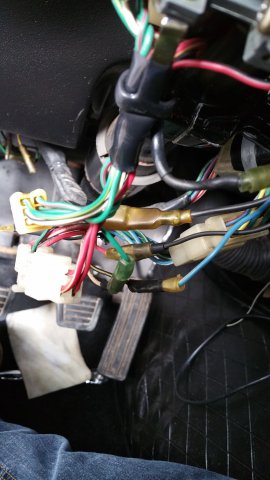

So I restored my dash in my early 240z. I had took pictures before unplugging wiring but some how they got deleted off my phone. I know, should have labeled them. Also I'm dealing with a slight wiring hack job from the PO.
He cut and taped up wires under the dash and installed a after market fuse block to fit bladed fuses kind of cool but not sure how important these taped up wires are, obviously they went some where at one time unless some were just used for factory options that my car didn't come with.
I will also say that I'm bringing the interior back to stock as much as I can. The PO had a fabricated metal plate cut to size and mounted it over where the map light, vents and entire face sat. Now I'm installing the stock components back, and attaching heater pull cables and wiring.  A little bit of a guessing game.
I found a 1970 wiring schematic but it is a little hard to follow with some of these random wires.

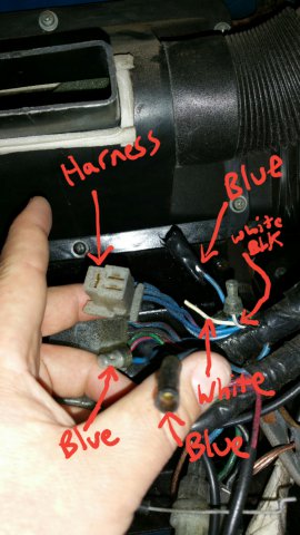

Does anyone know where this harness plugs in the picture below? Also where do the other 5 wires go?
3 are blue, 2 are white with one white wire having a black stripe.

If no one else chimes in, I'll take s look at my documentation tomorrow.  My recollection is that blues wires in the dash are often associated with the heating and cooling systems.
Those leads on the steering column appear to be factory original, so the FSM should show you exactly what they're connected to.

WRT the unidentified cut wires, I would try testing them for continuity between the cut ends and the same-colored pin connectors at the big junction block in the passenger footwell.  Once you've found the correct wire/pin location on the junction block, you can use the FSM data to nail down the what the cut wire was for.  Sounds tedious, but really shouldn't take long once you get going.

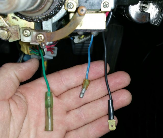

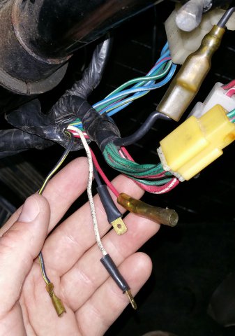

maybe someone could identify where these wires connect under the steering wheel
I have the same problem with my steering column wire harness.  Had a pictures of the installed wires from the last time I disconnected them but now they're gone and I need them again.  From what I remember previously, some or all of those wires change colors at the connections.
What we need is for some helpful soul to take pictures of his harness with the individual wires separated apart so we can identify them.  I found a couple of pictures on Google Images but none were clear enough for me to identify which wire was which.

Hope this helps. Not sure what year your car is, but this is on my early 71.
