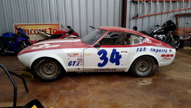

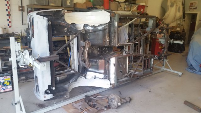

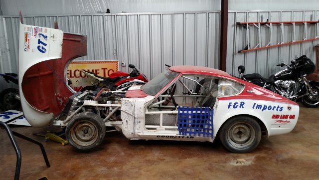

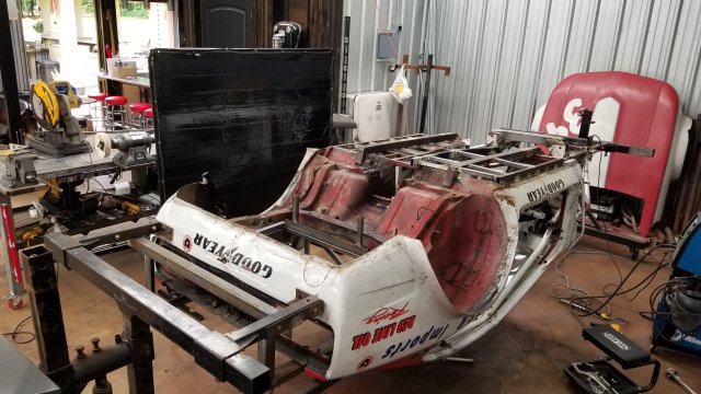

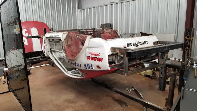

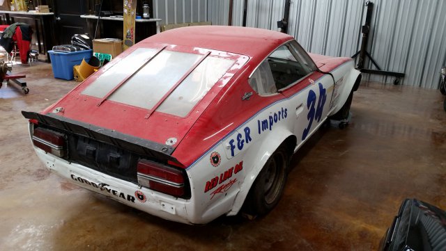

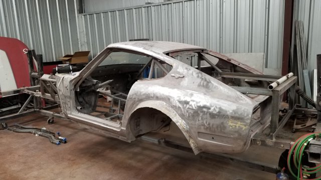

 I purchased a 1970 Datsun 240Z that was turned into a race car by the Datsun dealer when new and raced in the 70's against Bob Sharp at Road atlanta. Bought it from a guy in Ohio that raced it in SCCA up until 2007. Finally got around to stripping the car and have started the restoration process. The plan is to finish it for the MSR race in Angleton, TX end of July.

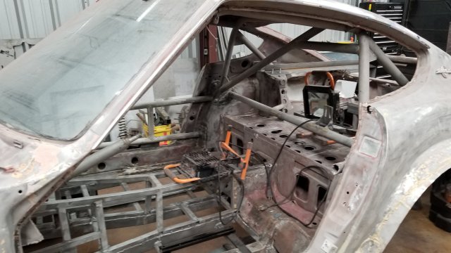

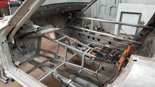

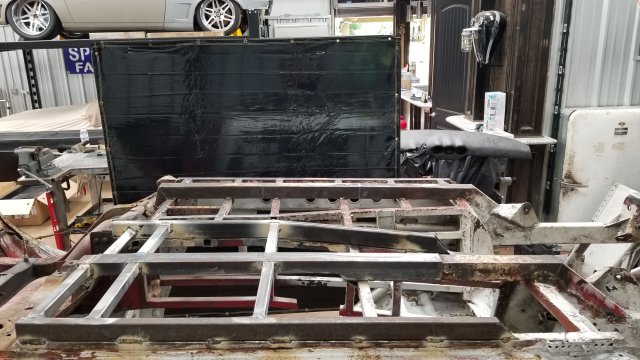

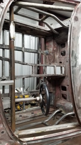

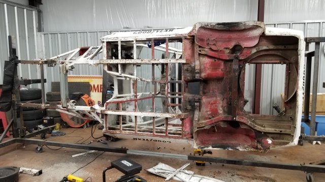

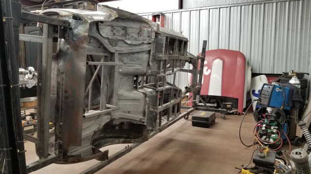

Some of the things that have been done to old race cars always intrigue me.  I wonder why they added the framework under the driver and passenger floor?  Seems like it would add no rigidity but a lot of weight....

I hear you, not sure about 70's engineering minds. Putting it back to preserve the way it was and also using it as a framework for the full belly pan.

NICE!! Keep them alive and running...........Is that crankshaft planned weight distribution?

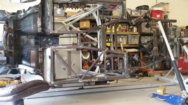

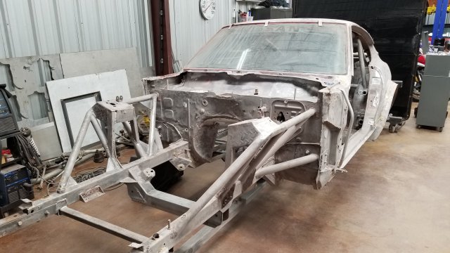

Looking good.  I will be very interested to see how your weight comes out.  The shell I started with looked much like yours now.  It was missing firewall, all the floor tubing, work around the transmission tunnel, and no windshield.  But had a full cage and front tubing similar to yours.  It weighed in at 500lbs.  I really really want mine to come in < 2k.
Thanks. I am hoping for the same but doubt it. My old blue Z was stock except the inside cage and weighed 2200. I am guessing this will be 2500.
