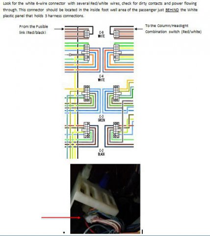

Did you check voltage at the headlight bulb connector or at the headlight sub-harness connection (round connector) at the inner fenders? There are two Sub-harnesses, one for each headlight just on the inside of the fenders near the radiator bulk head. That round connector at the sub-harness can get tarnished and need cleaning, resulting in too much resistance.
Power runs from the fuses (one for each headlight) through the C-4 (White) connector located in the passenger foot well (see pic), through the engine bay harness, then through the headlight sub-harnesses, to the headlight bulbs.
1) Clean the Fuse connections well. What is the voltage at the fuses?
2) Clean the C-4 (White) connector located behind the white mount up in the passenger foot well, check voltage here. (Red/yellow=Lft headlight & Red=Rt headlight). With this connector disconnected you should have no power to the headlight bulbs.
3) Clean the Sub-harness connections as well and check voltage. Are you getting only one 12v power source at each of the Sub-harness connectors? Each of the connectors contains two grounds (high & low beams) and one 12v (pwr from the fuse box; Red/yellow=Lft headlight & Red=Rt headlight).
4) What is voltage at each of the headlight bulb connectors after cleaning & testing through steps 1-3? Do you have multiple 12v power sources here but not at step 2?

I just checked voltage again at both the round connector sub-harness and at the headlight bulb connector, and they were the same (this is with the high beams pin on the 6-pin connector at the turn signal grounded directly to chassis). voltages on these three pins: 11.4V, 0.8V, 10.9V. That's the middle pin, the fatter one, that reads low while the other two read high, all of these are measured against chassis ground.
Voltage at the two headlight fuses are both 11.0 currently. I just checked the battery directly and it's reading 11.88V right now (lower than the ~12.4 I was seeing on Monday, I have the car "on" right now so the DC-DC converter should be recharging the 12V battery from the high voltage pack).
Voltage at the C-4 connector is 11.98V for both headlights. This is a bit funny because when I checked the voltage directly on the battery terminals immediately after this, it read 11.88V.
Verified no power at any of the sub-harness connectors for either side while the C-4 connection is open.
