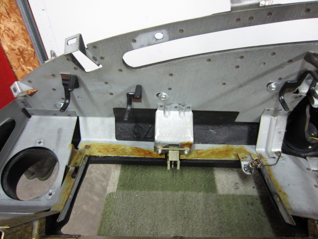

I have one. Installed it on the metal frame. Fit well on the frame but it's not installed in the car yet. Yes, their communication is poor

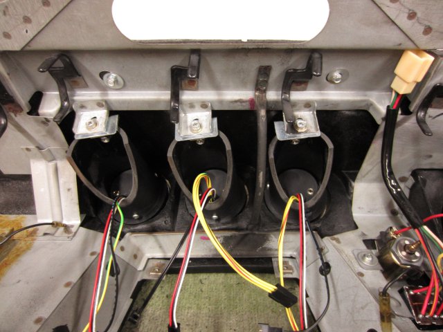

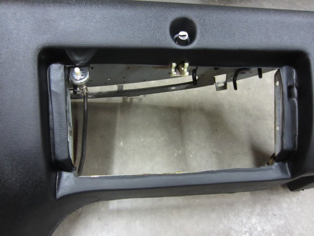

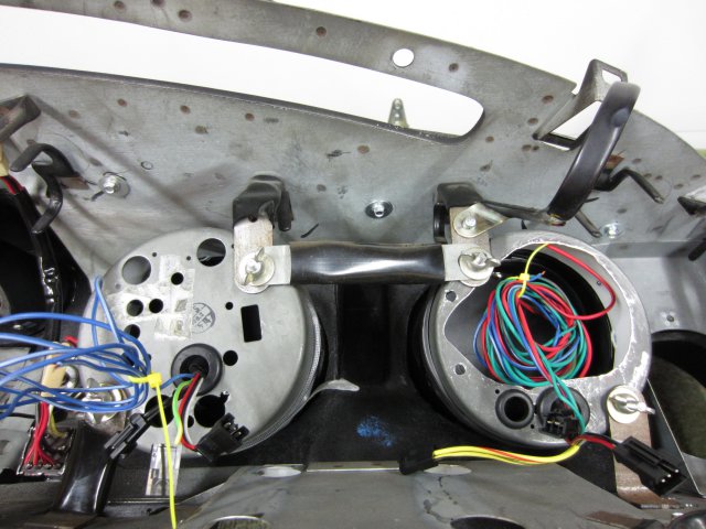

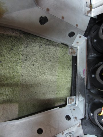

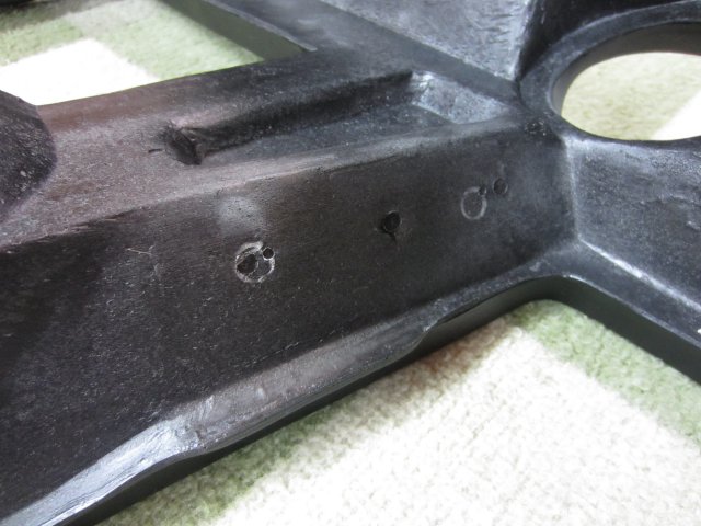

The dash seems to be great quality. It attaches easily although they were missing the attachment plates in the center heater control area. I used silicone adhesive in this area as well as the lower area under the glovebox, under the steering column area and the two sides. I used painters tape to secure until the adhesive dried. The original dash has extra vinyl in these area which is pulled around the metal. This dash does not.  You will see the attachment screws in the photo's. It's easier to use self drilling screws of the right length than use the original screws.

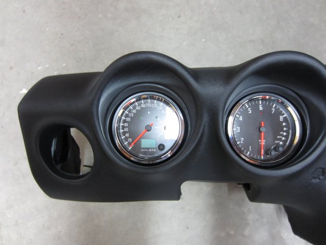

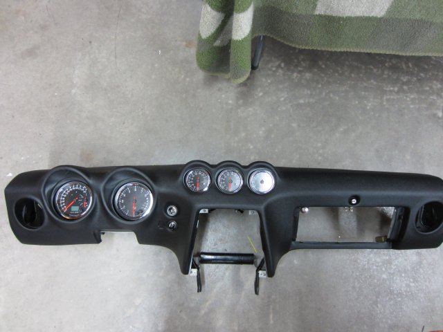

Wow, the dash looks great. The gauges are beautiful as well. Thanks for sharing the pictures.
Did you have to cut the holes for the cigarette lighter and the emergency light switch? And is your car 72 or 73?

Great pictures. That looks really good.

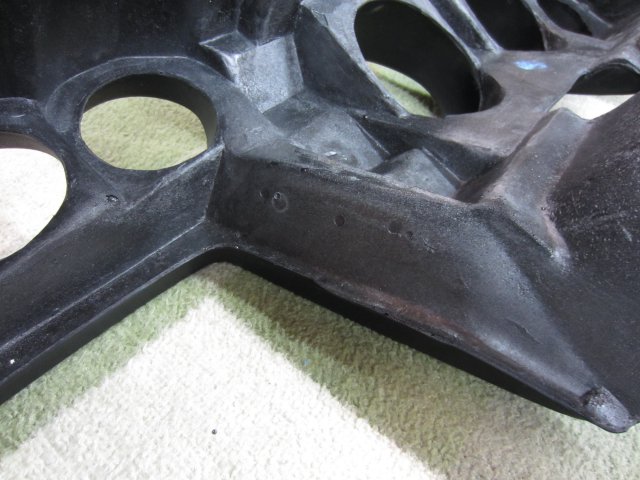

32 minutes ago, rturbo 930 said:

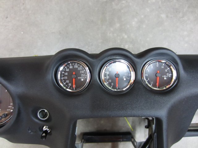

Just me, or are the three center gauge holes kinda misshapen?
I see what you're talking about. Maybe that's a shadow. It looks darker around the gauges.
Share this post
Yeah, that's from me. Working on the dash and leaving it rest  upside down on the top trying to figure out how to mount all the gauges. It flattened them down a little. I'm hoping they will return when upright. If you are keeping the stock gauges, it would be perfect as they fit the holes perfectly. These 2 5/8 gauges are a little small.

Yes, you have to cut those holes out. I used a step drill. Lot safer than a knife.
Edited by BJSZED
Car is a 72
