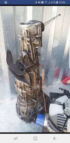

So, I'm swapping in a SR20DET and trans. I don't have the sr20det components here yet so I can't measure. I want to know where the SR20DET trans shifter location is in relation to the factory Z shifter. The car is being built up as a track day car. I want the lighter weigh and shorter engine to change front to rear balance. So I want to slide the SR back as far as possible to help that. I was wondering what kind of mods I'll have to make to get the shifter close to the same location. the engine is a s13 from a 180sx. Below is a pic of the 5 speed trans for the SRI. Thanks for your help

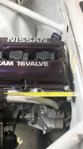

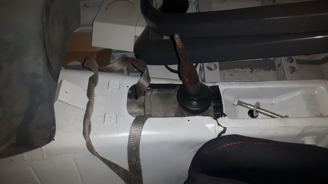

My car looks like this:
If you mount engine as near firewall that is possible, you ended up with gear lever like this. It is several centimeters more rear than originally.
I have already flipped shifter other way around, when it leads more forward. Shifter isn´t straight you know.
