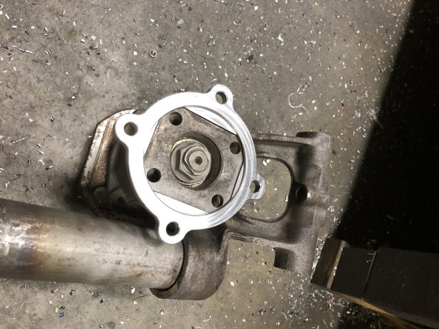

I make weld on adapters now that basically do not add any width to where the stock square companion flange sits. You even need to lightly grind the stub axle so it's flush with the companion flange. I ran both sides through their entire suspension travel. Contrary to popular belief, the axle is tightest and most likely to bind at full droop. Even with my adapters, both sides need the CV cages flipped to be safe. The adapters also work with the Rock auto reman z31 turbo axles, though they are not nearly as strong as the OE nissan ones. They in turn use the 280zx tripod style CV and there is no cage to be flipped. Luckily they are ever so slightly shorter and still work with the adapters.

I expect this is the route I will go. I'll use the Z31 axles and your flange adapter. The the diff end pretty much takes care of itself. and the outer end bolts to the adapter flange? Are you saying the 930 axles are the correct length or does the adapter make up some difference. I thought the cv setup might be lighter and more mechanically efficient.That's mostly what I was interested in.
