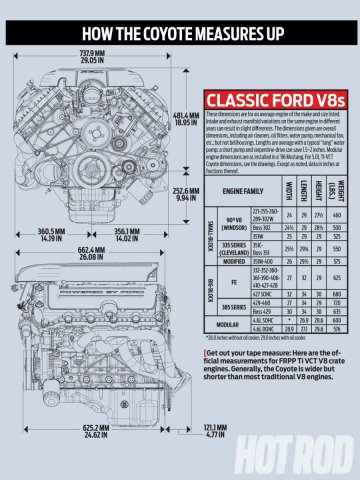

Same problem with height on the Voodoo/Coyote - too tall to clear the hood and it starts an inch shorter (maybe a little bit shorter less the covers). Stock form would nearly have the oil pan on the ground. Luckily there is a race pan available that gives the necessary clearance.
 Also, for what it's worth heads clear by 1" each side if centered. So the V6 will be golden that way.

Voodoo/Coyote is a tight fit both height and width - width is 2" less than the towers at the heads and that race pan will be a must have. T56 is a pretty easy bolt up and I have a wide ratio Magnum along with the aluminum bellhousing ready and waiting. Flywheel and clutch might be a challenge on the Voodoo (stock is dual mass unique design) but easy on the Coyote. Voodoo a little lighter than LS3 and Coyote a little heavier but we're talking 10-15lbs ish either way. Both have more progressive power delivery and naturally higher RPM because of DOHC and true dual VVT again Voodoo more extreme both ways. Sound is a bit subjective but I don't know how anyone can argue with the flat plane crank "brap", it's just insane. But a properly exhausted Coyote, maybe a bit cammed with some compression sounds downright mean. The new GT Coyote engine makes more torque and in a Mustang is quicker 60ft and quarter. Voodoo goes through the quarter traps higher mph with a slower time - can't get the heavy Mustang moving but catches it and surpasses after that initial takeoff but not enough to pass in 1/4. That might change less 1500lbs in the Z but maybe not as properly setup you might get the Coyote torque to the ground and if you do Coyote will be the faster car. Coyote will be half the price and not even close easier to find. Parts much more available (though not as easy as the LS) with some crossover but not all. Both are really unique installs in the Z. I know of one Coyote and mine will be the first Voodoo unless someone else beats me to it which is possible as my project is moving SLOOOW. For me the Voodoo is "best". You'll have to answer that question for you.
