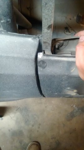

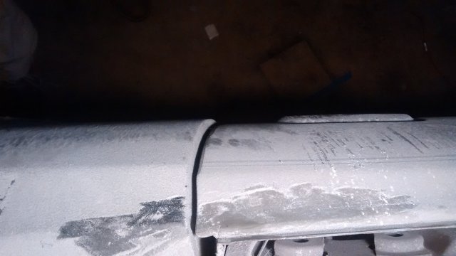

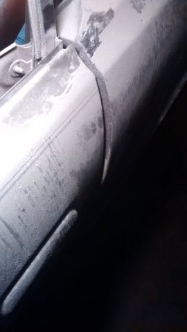

It was stationery during the whole process. If it did twist, it wasn't along the length of it, it would be like the front and rear are no longer in line. The hatch fits perfectly though, no taper top to bottom that i can tell.
The really dusty pictures are the drivers side. Both sides have the strikers removed and are being pushed closed.
Its odd.
Passenger side:
Drivers side:

The picture above of the passenger side door is metal on metal on the inside, no striker and no weather stripping. Once I add the weatherstrip it will make it stick out past the quarters.
I guess I'm going to have to clay it or something to see exactly where it's hitting and go from there.
