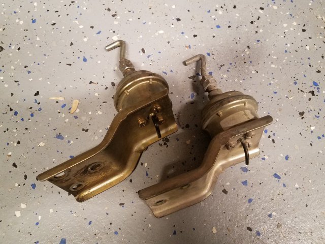

'78 280Z Fast Idle Actuator
random question but does anyone know if this could find its way onto a 240z with a vintage air kit? currently just have my idle higher in the summer then lower it in winter but would love a better solution to this...
Shouldn't be too difficult to add this bracket to the carb linkage arm, and then mount the FIA.
...But where would you pull vacuum?
Share this post
It is vacuum operated and triggered when the A/C compressor is turned on. I am not sure how the Vintage Air system works but I would assume it's all electric? I suppose you could get an electric vacuum pump that is triggered by the power wire for the compressor if that's the case.
