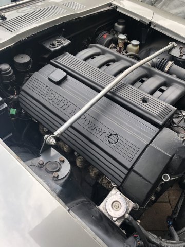

Also, post pics of your engine bay. There's not exactly a lot of BMW powered Z's running around.
