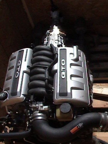

Well think i can join club at last been long time coming but just did first motorsport event with car so think i can claim it 99% finished
car is 71 240z
engine and gearbox are from 98 commodore hsv clubsport r8 or Gto as you know them in states ls1 with t56 6 speed with 70,000 km
started install in april 2005 got engine running june 2008
used jci install kit made up gearbox cross member myself say as jtr specs
Used jtr radiator
used jtr header on left hand side as its rhd car had to make my own right hand side header running twin 2.5" exhaust into single muffler at rear
had std computers securites burnt off and tuned mafless raised rev limit to 6800 and had mild tune done on computer
Had guy modify std wiring loom adding wires i needed to connect along with identifying wires for gauges
Had tail shaft made up to suit
fitted internal walbro fuel pump into tank
Fitted r200 lsd from dr30 skyline
28 spline stud axles along with 300zx cv axles
went bit crazy with arizona zcar buying there camber plates,coil over its ,lower front suspension control arms, diff moustache bar , alloy rear suspension hangers and bump steer knuckles usd modern motorsport rear control arms along with bilstein struts
plus i sectioned 45 mmm from struts along jtr idea using vw rabbit struts in front and old fronts in rear
ow and just love the power of the ls1 is just amazing so happy i went with the ls1
thats all i can think of now

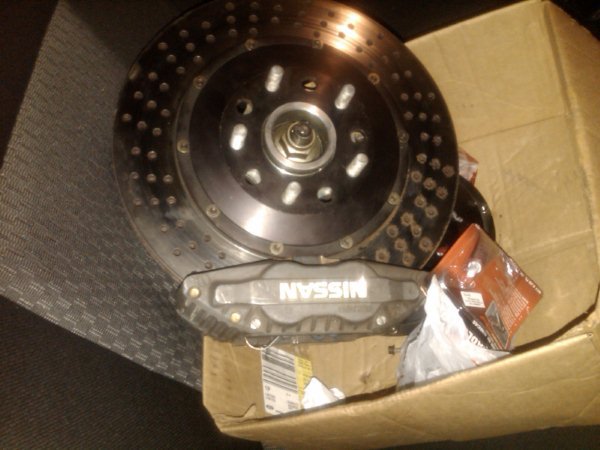

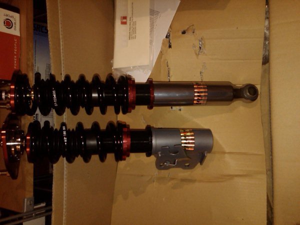

Posted 08 March 2010 - 08:43 PM
1. Year of motor/mods
2004 LS1 GTO / headers daft in..coils msd,tb big, maf vette,intake..predator..
2. Tranny
clutch RAM hd. aluminium flywheel,T56 , rear end 300zztt R230 custom shaft, 3;69..
3. Kit used or explanation of your custom mounts.
daft motor mount ,transmition cylinder clutch, line steering ...headers.
4. Any special accessories or parts needed for the swap, including fuel, wiring, etc.
wiring current performance stand..filter vette..cooling system cxracing radiator..
5. Date you started on the project, date finished 2009..2010..in progress stroker383 blower 112 magic..
6. Other car mods (suspension, brakes, etc.)
coilover megan racing, brakes 300z calipers 4 piston front 2 piston rear..disc front 13" brembo, pads hawks..
