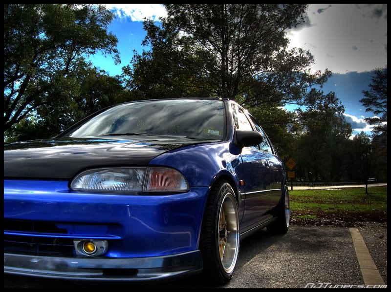

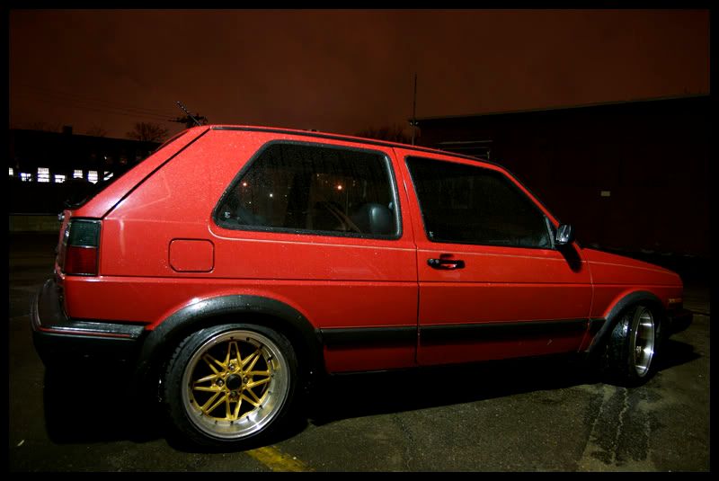

wearedrivenz    10
i really love the axis og wheels to bad they are 4x100 i want them on my s130
they are kinda of a copy of the work o3 but not exact the works have a step lip
and these wont cost you your first born or arm
the pics are not on z cars, but you can get an idea of the massive 3 inch lip and proportions
