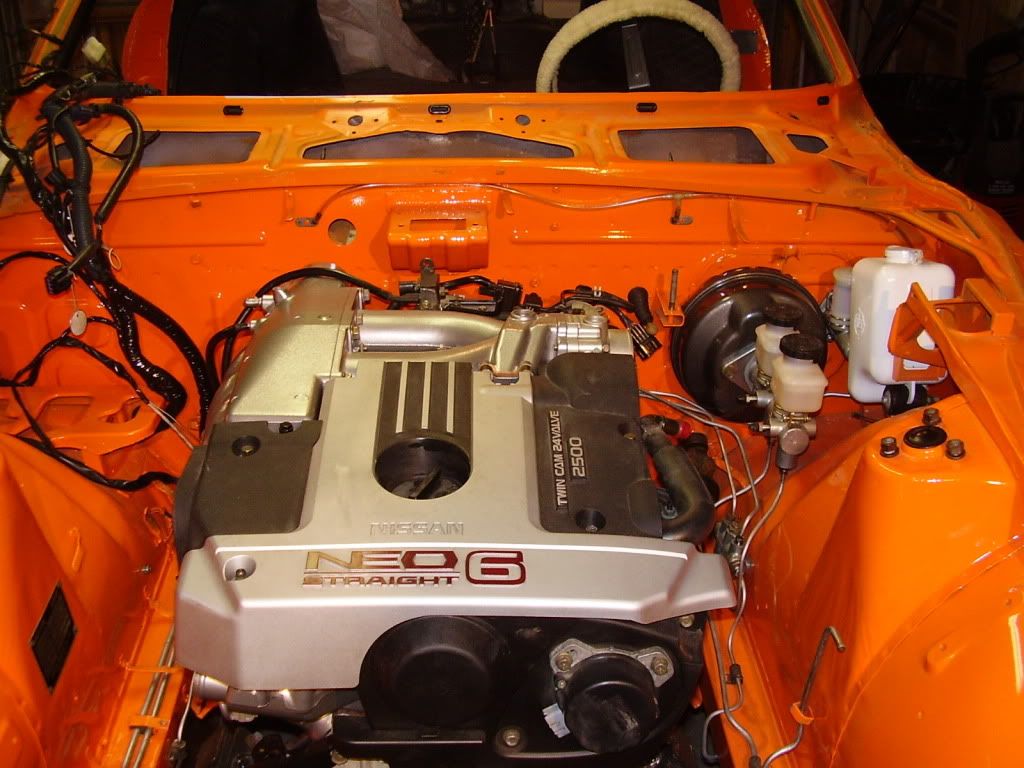

Hi guys. Just picked up my first 240z and keen on updating the brakes. Found this on eBay. Do you think this is the part they are speaking about?
You lot prob can look at this and know if it looks correct better than I can.
