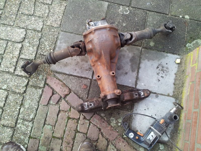

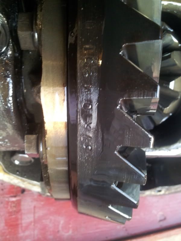

Posted 02 July 2012 - 04:36 AM
I have a '75 2+2 260z. I guess it is a euro model
It has a R200 open diff with final ratio: 3,7
Posted Image
Posted Image
Posted Image
