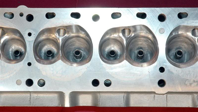

Phils head is about ready to ship. Just waiting on the Lash pads to arrive from Nissan, hopefully early this coming week, then a quick cold valve adjust, package, then off to Phil via UPS.
This update is the valves, springs, spring seats and stem seals. When installing the valves, you should always use some form of lube on the valve stems even if it is just plain motor oil, we prefer to use high pressure assembly lube on the valve stem before installing. When installing valve stem seals, you want to make sure and use those little plastic condoms that are supplied in the stem seal package, (top picture, middle valve stem). This protects the seal itself from getting cut while going over the keeper grooves. Those little plastic stem covers are always too long so I always just cut it half. When installing these Ford V-6 Viton stem seals, you can use a 3/8” drive, 12mm deep well Craftsman socket to “gently” push the stem seal onto the guide and it will seat with a positive click. Be very careful and don’t’ get the seal cocked on the guide, but “gently” push it on using the palm of your hand. The socket, or whatever tool you are using, should “only” be touching the outer metal rim of the stem seal, NOT on the upper seal portion of the seal that surrounds the valve stem itself. When using the Felpro Viton seals like these, extra care needs to be taken as it is very easy to ruin the seals when installing them. The inner rubber lining of the seal itself can easily get caught and tear and then it will wad that rubber lining up on top of the guide itself causing the top of the seal to bulge out. We’ve had many a so called “mechanic” bring cylinder heads to us that they had just done a quickie valve job “themselves” for a customer, only to find that head they just assembled and installed now smokes terribly and they can’t figure out why. That is when they finally bring it to the machine shop to figure out what they did wrong. Most of the time we find that the stem seal was incorrectly installed, either they forgot to use the little plastic condom and the keeper groove tore the seal, or they wadded up the seal as described above, or they didn’t seat the seal all the way down on the guide itself and it popped off the guide. While on my soap box ranting about mechanics, the other bad habit these same mechanics have is with that scotch brite pad on the end of an angle head die grinder! I can’t remember how many heads I’ve resurfaced because a mechanic got over zealous with his “surfacing disc”. The common excuse given was, he wanted to save a head surfacing fee for the customer who came into their shop with a blown head gasket and thought it was just a bad gasket, (usually there is another reason WHY the gasket blew, but you can’t tell these guys that). They then go on to create another blown gasket as soon as they fire up the engine cause the head surface now has waves big enough on the deck, to surf on caused by their little air powered gasket remover. I’ve had to shave as much as .030” on one occasion to save a young mans attempt at cleaning the old gasket off of the customers cylinder head! He was fresh out of auto tech school and tried his darndest to remove ALL the old gasket material, and boy did he do a good job of removing that old gasket… as well as a lot of aluminum…. I still chuckle over that one… I really don’t have an issue with those buffing discs, we use them all the time. It is “how”, “when”, and “where” they are used that is key.
Ok, enough ranting about mechanics. Here are tonight’s pics till the lash pads show up…
