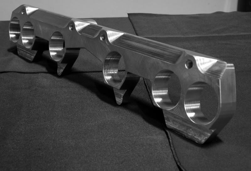

I'm working on drawing up Ron Tylers Intake Flange/Manifold in Solidworks. I promise to post pictures of the solidworks rendering this weekend. I'm going to get a quote on having them machined next week.

I have to talk to Ron about machine the flanges he designed. We'll get something worked out.
The one thing about Ron's head flange is its designed for oversized port diameters. So essentially you need to atleast port match the cylinder head to the ID of the flange port bores. You can read more about Ron's design in the members project section.
Do you people want a flange with standard port sizes or the Ron Tyler enlarged port sizes? I feel the later is where you will see the most gains from this custom intake manifold.

Justin is referring to this flange...
Its an old picture, prior to buffing out the tooling marks. For more recent pictures, different views, and the intended use, click.. http://forums.hybridz.org/showthread.php?t=117607
Justin is right, and they're raised a bit as well. The flange is currently sized at 1.753" OD. There is some amount of latitude in runner ID with alternate wall thickness tubing. With the runner height as-is, anything smaller than 1.5" ID will put the floor of the runner above the floor of the port.
To some extent, some of these variables could be manipulated, beforehand.
Justin and I will continue our plot to build a few. Until then, keep us posted on what you guy's want.

Definately the larger port size for me. It would make no sense to go with the smaller port in my case because I'm looking for more flow and HP gains.
Agreed. The N42 manifold runner size is only 53% of the intake valve (stock L28). There will be gains realized with a larger runner. At 1.5" ID, you bring that number up to about 74% of valve size.
