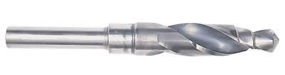

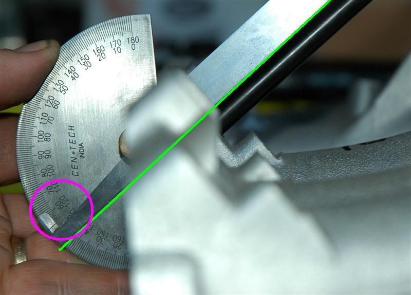

The angle of the OE injector port is 54 degree off the head/manifold mounting flange, (see pic below). The injector is aligned directly with the intake valve which is offset in the opening of the port itself, (port is cast off center from the intake valve). Also, you will want to keep the length of the injector bosses short so the fuel is able to spray into the port and not against the interior walls of the injector boss.
I used to individually bore the injector ports in the fuel rails and manifolds for O-ring style injectors with a boring bore, (several step operation). Talk about time consuming. We recently purchased the 14mm injector cutting tool pictured below and it sped up that process considerably with comparable quality.
