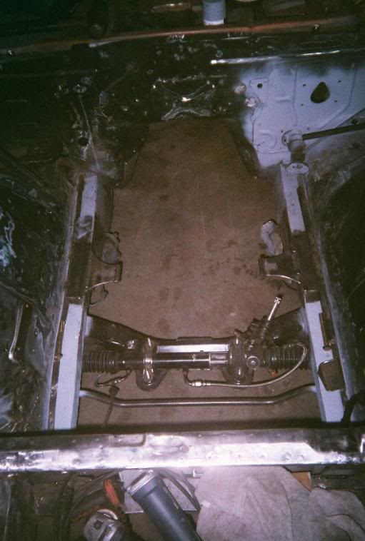

LT1 and Subaru Rack
if u use the right inner tierod, u can use the stock suby outers in the z w/ zero modifications...
Which inner tie rod are you using??

Moog EV167
i got mine from napa, someone else aquired them from car quest... i actually got the part# from another Z guy here locally... ive changed them out, they fit great... only thing is they dont hav the slight bend to them like the stockers do, so there may be a possibility of bumpsteer, mabe *shrugs*?... but it is a "bolt in" installation in regards to the tie rod assembly... then thers the whole fabricating mounts for the rack and making lines and such, lol...
u must mean the middle U-joint?... i didnt want to route it that way, but no matter how i ded it, it wasnt gona fit w/ the 1-3/4" block huggers... sooo, in goes the center joint, then the support, gah... its tight, but no binding... i still might modify it again (this would be the 3rd time)and try to get some of the angle out of it... i made a polyurethane rag joint for it, iits the white disc in the assembly near the firewall/collum...
this might be easier using the JTR style engine mounts, but the shaft out of the suby rack wanted to go right through the datsun mount on the crossmember... nuthins been easy on this build, :P haha, guess thats the challange of fabrication...

Could you take a picture of your setup and possibly measure it from tip to tip of the outer tie rods so we have the dimensions of the setup.
I looked up that part number and it references back to a Toyota Celica ST.
And you were able to thread it right into the rack and the Suby outer tie rod with no problem?
The outer Suby ends, did your's look like the ones in the pictures from 78lt1z?
What about the taper of the Suby ends, how did it match up the the Datsun steering arm?
Wheelman
meh, i dont think i could get a descent photo of the overall length since its all sealed up, and that new inner tierod boot was a PITA to get on.. but ill get a pic of the installed version, haha...
i had no clue that it was for a toyota, but ya, it all threaded together quite nicely... the toyota inner(now that i know) threaded right into the suby rack, and didnt bottom out the threads, so all was good there...
my suby outers look just like the one 78lt1z has pictured, its kinda a short, stubby tie rod end...
i havnt thrown dial callipers on it to verify, but the taper seems the same, no slop, no noticable difference...
the hardest part was changine the inner tierods, and getting a secure hold on the suby rack while trying to break loose the original suby inners...
