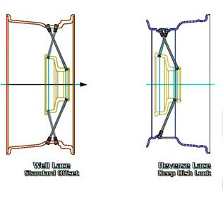

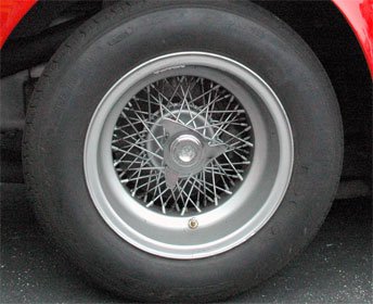

Here's a shot of the Borrani. You can see how broad the original aluminum (?) rim is. I am talking to Dayton right now about lacing their aluminum rims to use a hub that can work with the knock off adaptor that fits a Z. I'll post when I get the info.
The second photo shows the reverse lace that is needed to get the offset needed to fill the well and handle those tires.

Yep... you're on the right "track". Please note: There are many placement posiblilities for lacing the spokes... lip, rim, normal, reverse, reverse lip, reverse rim... you get the picture.

Here's a shot of the Borrani. You can see how broad the original aluminum rim is. I am talking to Dayton right now about lacing their aluminum (not steel) rims to use a hub that can work with the knock off adaptor that fits a Z. I'll post when I get the info.

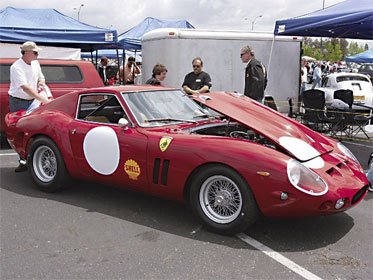

Now here's a pretty car. SpeedRacer has one of the nicest GTO's around. Chelle's is another to be greatly admired.
