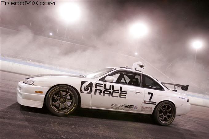

Volk racing TE37 15 x 7" 4 x 114.3 $480 a piece drum roll please..... under 12 pounds yes
I think this is love
