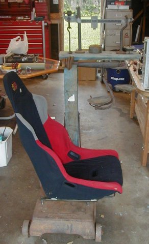

Holy crap!!! that is going just a little over the top in my opinion... Well here are a few suggestions to make the car lighter: insure that you have the early style doors with the much lighter side crash bar in it, go to CF hood and hatch http://www.betamotorsports.com/products/CarbonFiberHoods.html, http://www.betamotorsports.com/products/CarbonFiberHatches.html, of course use Lexan in the hatch. Fiberglass fenders will save you about 1 or 2 pounds but they will not rust. Go with after market LCA's and coil overs they are lighter and adjustable. Use non reclining fixed (with no slider) racing seats (not the knock off looks like a racing seat crap you find at some auto parts stores). There are more things you can do but at this point the car is already getting outside of the daily driver catagory and to go much further it will be outside the weekend driver catagory.

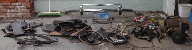

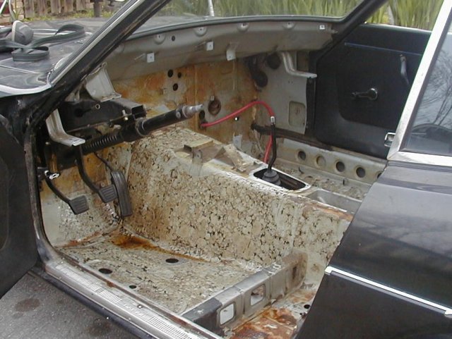

For a cheap solution, strip the interior remove the sound deadening, burn the sound deadening off the bottom of the car, light weight seats, Lexan windows, light weight battery. Remove dash and heater. Ditch the bumpers if that's legal where you are at and you want to take the risk. You can lose a decent amount of weight with those things.
Next up bang for buck wise is FG hatch and hood. Fenders are 11 lbs stock, so again, not a good call to replace them as far as return on investment.

You have to consider where the weight is in the car...
I would leave the weight in the bottom of the chassis and start thinking about how you can shave weight off the top...
Replace all glass with plastic...
Loose the hatch all together... replace with a large thin sheet of poly with aluminum reinforcement...get rid of the top hinges and hinge plates as well..
Most people have to cut some holes in the roof to complete some of the top welds on the cage... you could vac. form a sheet of prepreg CF over the original roof and then cut out all of the sheet metal leaving only the drip rails and the window frames... then bond the CF roof onto what is left... seems easy enough...
The doors can be significantly lightened... in many stages... until you just pin a CF door skin to the cage...
In fact all of the outer body sheet metal can be replaced with CF skins... trim all of the sheet metal away leaving a "halo" of the original panel to fasten the skin to...
Aluminum hardware is light.. but it will cold weld itself eventually and must be drilled out to remove... but many of the bolts can be shortened and lightened...
When you get into frame and unibody work... you can pull a lot of reinforcement out of the bumper and front clip areas... Front bumper mount doubler plates and their weld nuts can all be removed... the front lower tie down hooks have LARGE 1/4" thick steel plates welded into the bottom front of the frame rails.... The rear clip can be lightened by removing all of the bumper mount gussets and the center gusset...
Remove the hood hinges, door hinges, hatch hinges, rear cargo doors, remove the hood latch plate and the firewall mount,
swiss cheese everything.. and then re-seal the body of the car with poly tape and paint...
some example pics..
anyhting you add should be lightened wherever possible...
