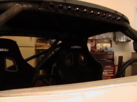

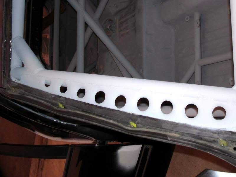

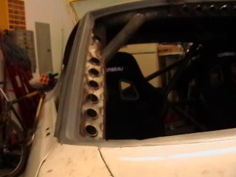

Here is a pic of MY CAR with the front end gussets as it stands now.
I am considering extending the front roof gusset all the way across instead of just the middle section. I am also considering doing the same thing to the rear hoop(center or all the way across).

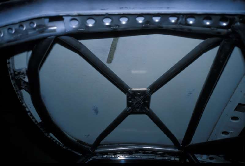

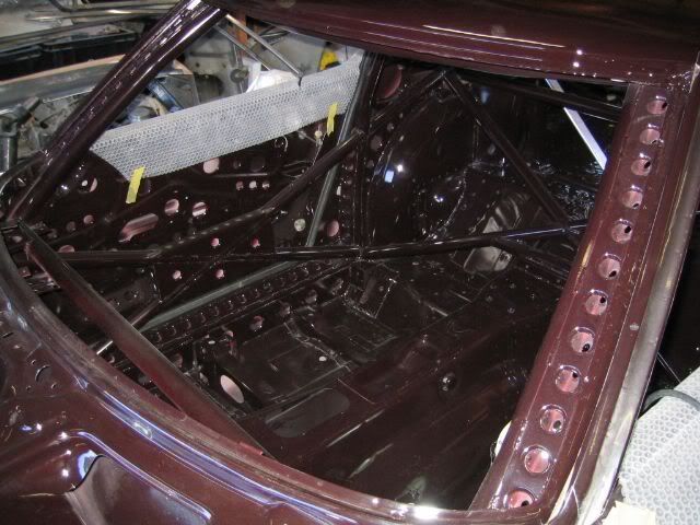

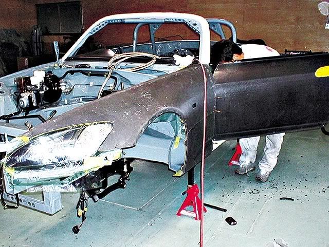

Here are some pics of a really complex Japanese 240Z buildup. These guys gusseted BOTH SIDES of the A-pillar tubes to the chassis. They also did some amazing things with sheetmetal in other parts of the car.
Here are some more examples of a Datsun with cage gussets.

I my particular installation the gussets are invisible from inside the car. In fact the exact position of the A-pillar tubes was carefully chosen to make them run inline with the factory pillars. They do not reduce visibility at all.

In relation to the types of gussets used; there are several types employed in my car and in the example pictures.
The punched strips are lightweight and have a great deal of strength in sheer. In fact, the Japanese 240Z has used them to encircle the roof. Assuming that the roof is stiff enough, that design will keep the upper cage tied to the roof in all the various ways it could move except up and down. I doubt that they will do much in a rollover which would compress them handily. They would however make it much harder to tear the roof off the car from above(for what it is worth). In this light they do not contribute much to safety, but they may do a lot for chassis stiffening.
The tab type gussets are often made of heavy guage material(>18g). They are often tied to structures that are formed using 22g or lighter steel. That is a problem with using small tabs of metal for gussets. They overload small areas of the chassis and form highly stressed areas that are subject to fatigue and work hardening. The strip type gussets have a significant advantage in that they tie long running lengths of metal together to better withstand sheer forces. The tab gussets have their place in designs that use them to tie heavier guage(or multiple layered) sections of the chassis to the cage. The tab gussets are often performing double duty as chassis gusset tabs AND mounting points for other parts of the interior equipment.
The other types of gussets are formed 3D gussets that are used to box certain areas(especially corners). These can take many forms. They are often bent using 16g medium thickness metal. They can also be formed using heavy guage material that is welded together to form a 3D piece.
This particular gusset is formed with relatively light guage material. It looks like another tube runs down that path and is simply "boxed in" using curved flat plates. BUT it is actually nothing but sheet metal. there is only one A-pillar tube, the rest is nothing but a carfully formed piece of sheetmetal.

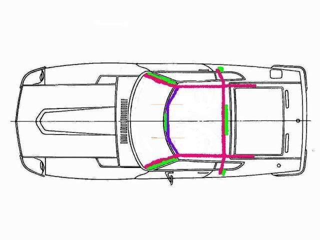

Here is an overhead rough sketch of the roof bars and gussets.
