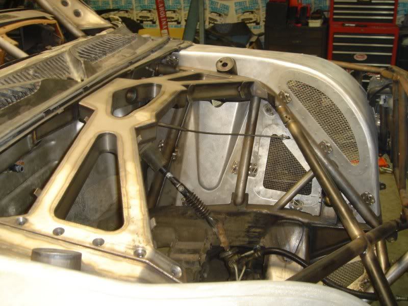

Here's my front strut tower bars. One connects to the cage as close as I could get it to the rocker, the other V's to the dash bar and then goes straight back to the rear strut towers via a bar right down the middle of the car a la Herb Adams in Chassis Engineering. This necessitates a right side net. I could have done an X from the strut towers to the A pillar bar at the dash bar nodes on either side. That probably would be a better solution, but I think that would make it a lot harder to get the engine in and out of the car.
My other nit pick with what I did is that the tube to attach the strut tower to the sway bar mount is straight, but it has to hit a bracket off of the strut tower instead of hitting the tower itself. The bracket is pretty beefy, and this is not so much to brace the strut tower as it is to brace the frame rail, but still I think I like bjhines' solution a bit better:

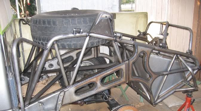

Here's the battle S30Z shown with tons of cage to body gussets.
It says that it's a 23 point cage.
I also don't see the need for such large body to cage gussets, I think smaller ones in key places will do the same thing.
