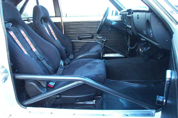

I am also going with the C5 Vette (Z06) seats in my Z, but I loved the 3rd gen RX-7 seats (the R1 version came with black suede) and were very easy to install in my 510 and would definitely work in the Z.
Posted Image
Gary Savage - http://www.Savage42.com
