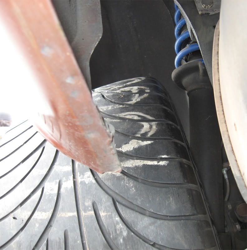

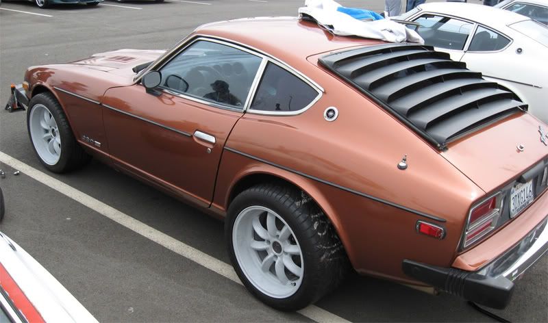

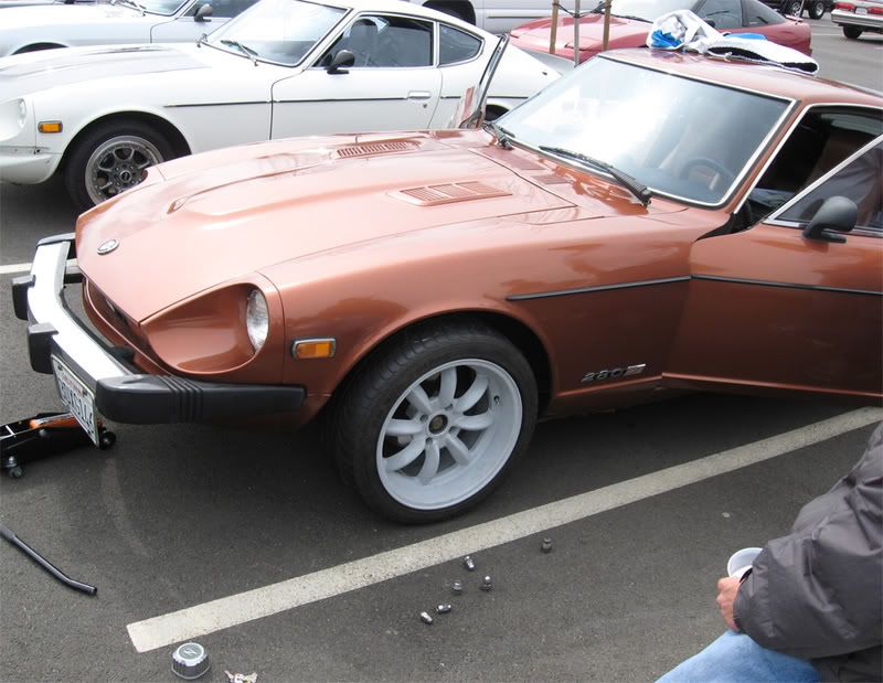

I was able to get some better pictures at the Vacaville meet n' greet today. It was nice. Thanks to Gollum, Ncfisher, and Stealth-Z; we were able to mount up the two sample wheels on a bones stock 1978 280z. Just look at that rear suspension clearance!
