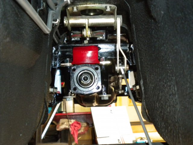

So here's my Progress so far. This is all on an early 260Z (2/74) I got the mount and POR15'd it after media blasting it to help the POR stick better. I went to go mount it and found that the 260Z's exhaust hanger is in the way. 4 spot welds, an air hammer and large mallet later, the hanger is gone and I'm ready to slip the RT in place.
Of coarse, the fuel lines and the rubber bracket are in the way. So I move the bracket forward and gently push the brake and fuel lines upward to clear the R/T. After that, the instal was smooth. Couple smacks with the plastic mallet to align the bolt holes and we're good to go. Had to lift the diff into place and ballance it on my shoulder while I was bolting it to the Mustache bar, then lifted the front to bolt up the poly to the R/T.
In the 4th pic, you can see that I tightened the Poly so much (to make sure it was tight) that the inner plate started to twist. I fixed it shortly after the picture was taken.
Here's the pics....
Dave.

I used 2 bolts on top of the poly mount to keep it from twisting. The single hole the "RT mount" was designed with, will allow the pieces to twist when you tighten them.

I ended up dropping the mount, and welding a dot of steel on the mount so when I tightened up the Poly, the weld caught the hole and kept it from twisting.
