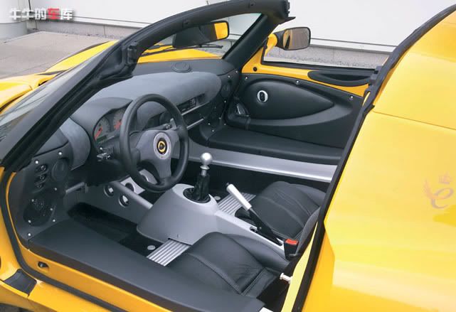

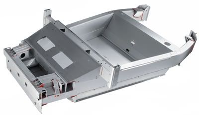

WOW! then tell me how bad is your chassis twisting. im thinking about running two beams along the side of the door like in the elise chassis. I think the only problem would be the space between the door and the seats. I guess that why the elise doors are shaped so oddly.
Elise chassis.
check out the inside of the elise
also i would need to strengthen that metal tube the stick shift sit on, i forgot the name of that, oh well one of you should know.
