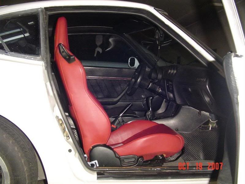

On a side note, found these seats. Don't know if they're from a 240 or 280 (or are whether it makes a difference if they came from 240, 260 or 280)? The guy live about 250 miles from where I live. How much should I offer him?

The Z-car seats you posted an image of appear to be 280 style seats. I cannot recall specifically if they will bolt into a 260, but I am 99% positive that you can bolts the later style seats into the earlier cars easily, and vice versa.. BUT I am not certain. Nor am I certain which style seats your Z came with originally... Does the 260 have seats in it now? If so, check out the mounting brackets. I can see the "ears" on the front of the seats in the picture; those are the "later" style front mounting points, and if the seats in your car have those mounting points then they ones pictured are a straight bolt-in swap. If not, then your seats are probably the type that has "studs" dropping straight downwards from up underneath the seat.. Please forgive me, I haven't worked with 240 style seats NEARLY as much as 280 style, and all the 240 stuff was at least ten years ago playing with my dad's "grey ghost" as a teenager.

As for the 280 seats, the guy just wants to get rid of the parts car. I'll offer him $50 for the seats and have him send them via Greyhound.
Ps, the seats are not dirty, the suede looks that way in the pic.
