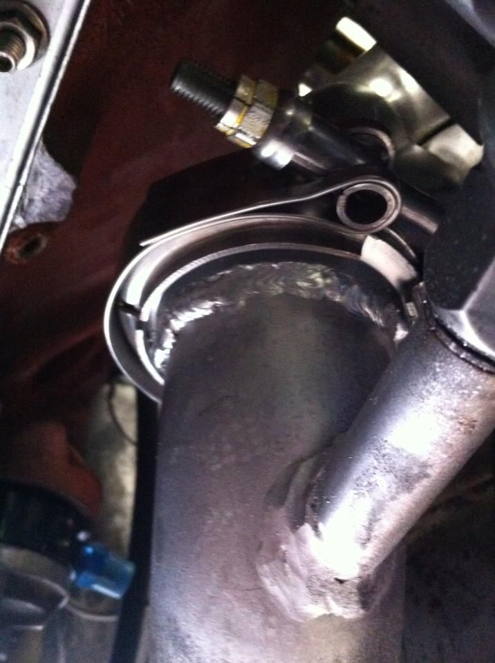

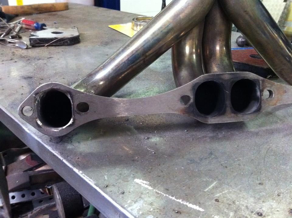

I got the V-band clamps/flanges and did a little port matching today.  I got the exhaust system buttoned up completely today.  Got the radiator to install, and all the fluids to fill the motor/trans with.

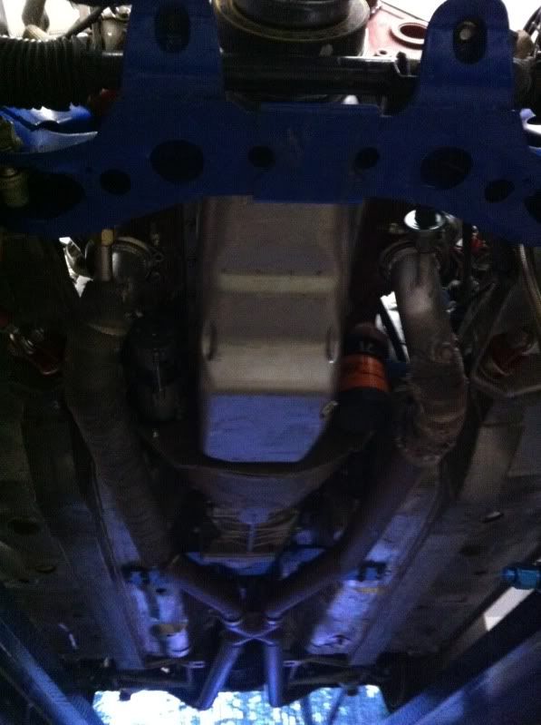

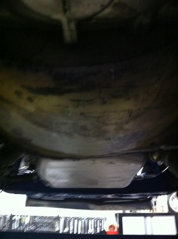

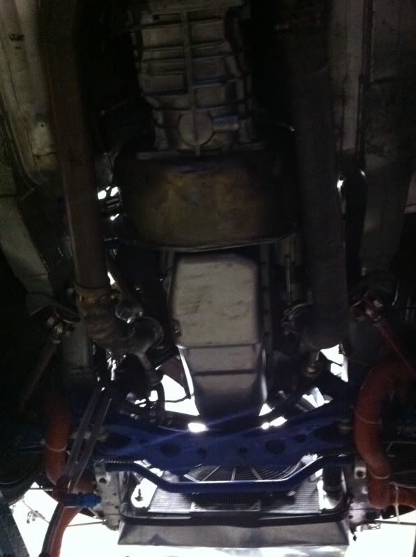

Really digging this cheap pan and how it "works with the mixture of parts... And I'm ONLY down 1/2 quart in total capacity.  You don't need the additional trap doors on more sexy pans because you don't have the "kickout".  2 trap doors, a windage tray and 7 1/8 deep.  Couple things about this pan that are worth really mentioning... It claimed to be 5 quarts and a cheater IMCA model.  It also claimed to be a 7 inch deep pan.  I measured 6 quarts, and it measured 7 1/8 from the top of the rails on the pan to the floor of the pan internally.
This is the pan I bought... Very impressed with it, especially for $59.  I'd have paid $250.
http://www.kmjent.com/cart/sbc-small-block-chevy-imca-racing-cheater-oil-pan-pickup.html
As you can see, it clears the exhaust nicely and allows you to get to bits undercar.  I'll be running 6.5 quarts with the cooler and relocated filter/lines.  I'll add the 2 quart accusump.  So that'll give 8.5 quarts instead of 9 quarts with the other system and the kickouts on the champ pan.
