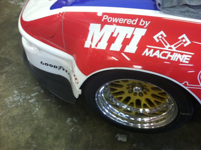

CCW made my wheels and they are awesome. I called BBS up the road from us (MTI Racing). They knew who we were and even offered a discount. I indicated that I wanted the same three piece race wheels that I had on my first 240 race car 28 years ago, just not 15inch. They said they no longer made the "snowflake" pattern but had the mold and would reproduce it for me, how many sets did I want. I said we probably were going with three sets, one for rains and two for slicks. He said no problem that would be $30,000. There was a long period of silence as I was getting up off the floor and tryng to catch my breath. I said I really appreciated his time and would get the specs and call him back.
I obviously was born at night but not last night...................I can build someone a great track car for $30k.
I called CCW and they were able to make the three piece race wheels I wanted for $2,800 a set. (THATS ALL 4.) They called it their Classic pattern with a stepped lip and would anodize them in gold and it would take around a month to get them. If anyone has seen my car in person you would attest that the wheels are very period correct and look outstanding. I highly recommend CCW and have used them on numerous projects, all with great results. They work on their own time and dont like to be rushed, so dont order them and call them every four days wanting to know where your wheels are.

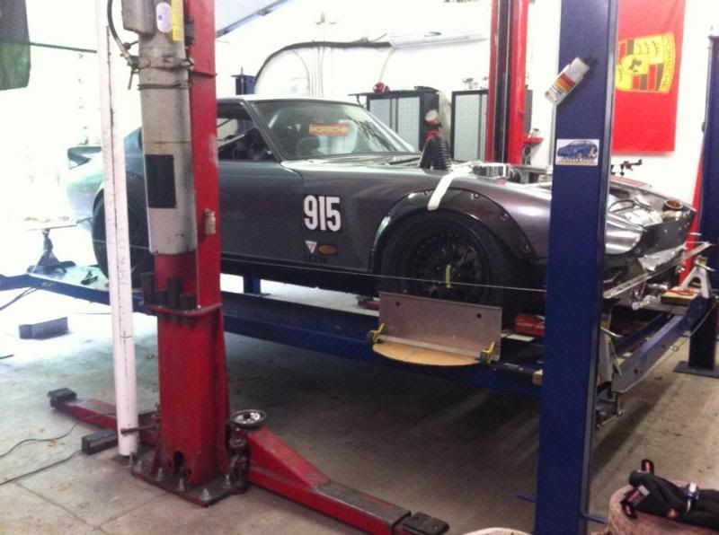

Was aligning the car this evening...
943576_644077575608670_892630658_n_zps62

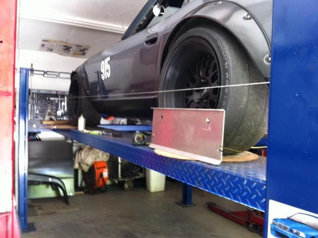

Everything seems correct on the front, with R Camber at -3.0 L camber at -3.2/ L  caster at +4.3 R Caster at +4.4 with toe 1/16th total out.  Rear is at R camber at -2.8 L camber at -2.9 and the toe is about 1/8th!!! total IN.  Gotta fix that.  I did unbolt the rear suspension bits over the fall last year when I was doing the mustache bar mounts.  So that's probably where the toe got jacked... I'll resolve it asap!
Made a bit of progress this evening.  Wrapped up string alignment on the car and removed a tad bit of toe out up front and toe in at the rear!
Aligningthecar_zps0c571724.jpg316031_645082685508159_993485355_n_zps98

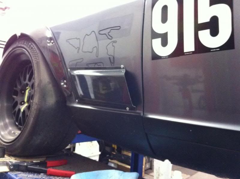

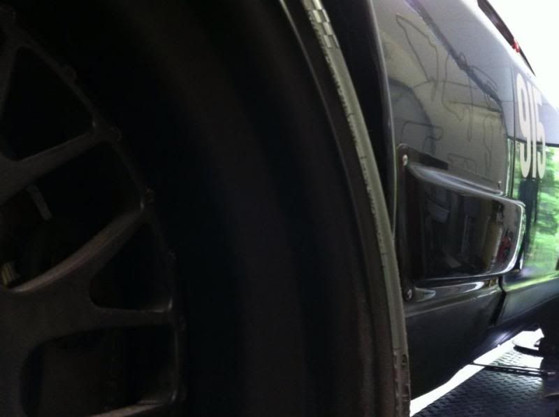

And I started installing some more carbon bits to help with the air flow around and under the car:
247555_645013728848388_583634819_n_zps13
179479_645081922174902_1626938464_n_zpsb
577493_645082115508216_1185217434_n_zpsd
