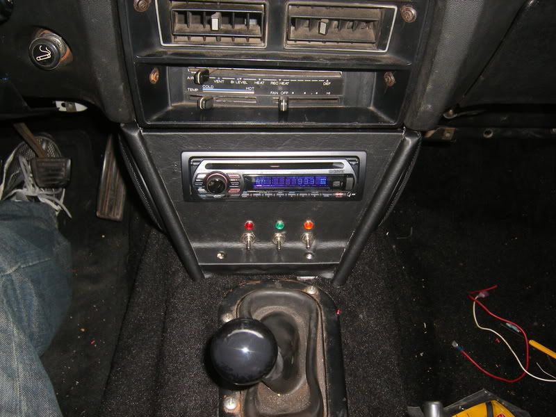

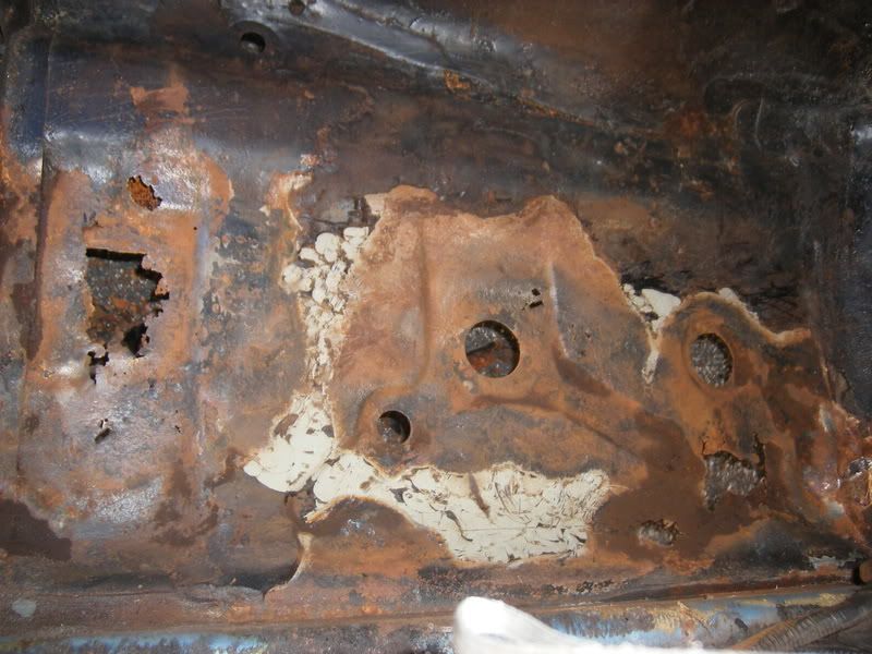

Well a few months ago I had the stereo stolen out of my car. It seems like the stock console never really held it a modern stereo in properly and I didn't particularly feel like giving away another head unit so I decided to pull out the stock console and build my own. At least thats how things started. While thinking about how I was going to do this i decided on building a two piece unit and carpeting the tranny tunnel between the front console and an arm rest. This lead to me deciding to carpet the entire front of the car. Pulling the passenger carpet led to a reminder of the rust holes which had to be fixed as well (pretty much a case of one thing leads to another and another and ...). Finally two months later the car is carpeted and the rust holes are fixed and part one of the original project is complete. My new center console now holds a standard single din unit very securely.

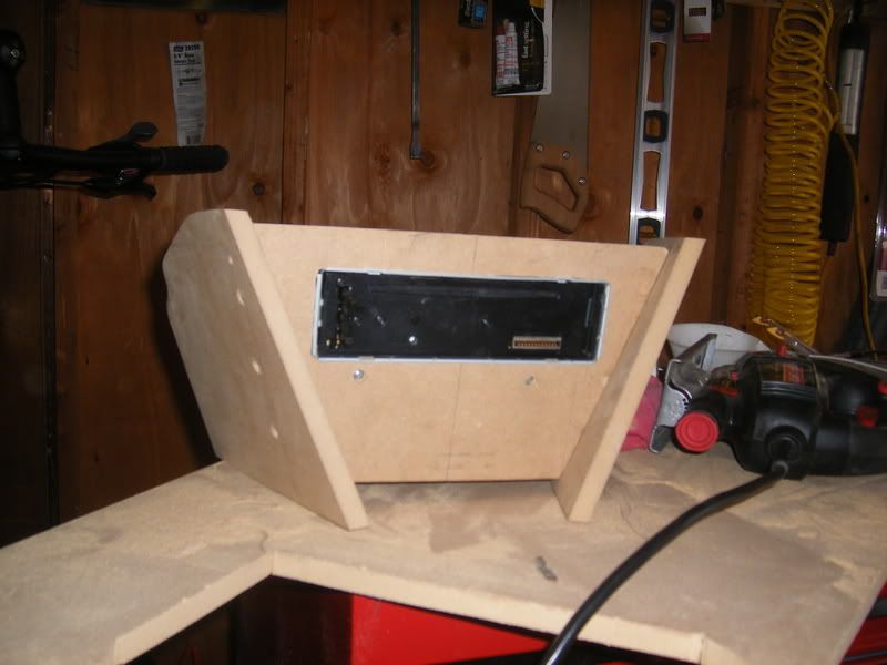

the bare basic design made of 1/2 inch MDF

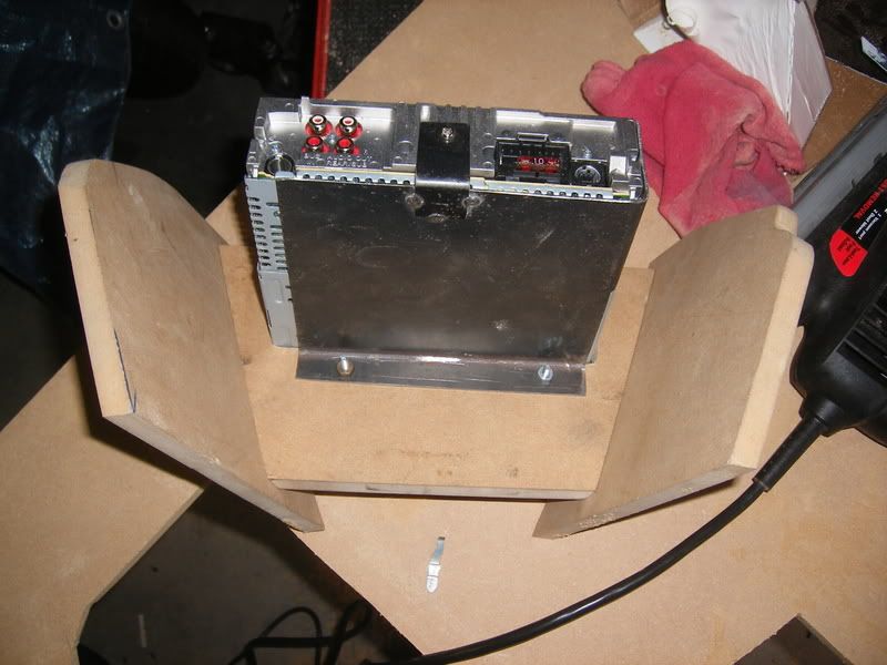

heres the back with sheet metal support and mounting bracket

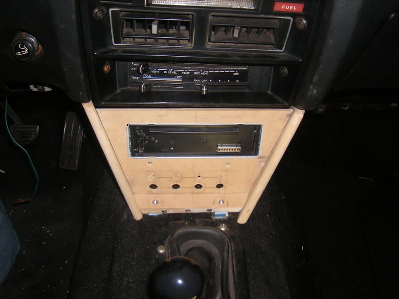

bare console fitted in place

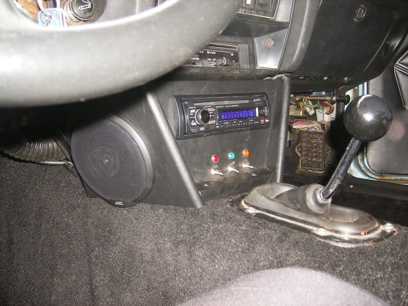

Vinyl covered with switches and speakers

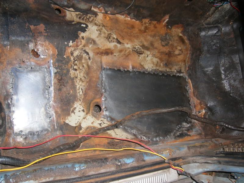

some of the rust holes and patches
For the most part I'm pretty darn happy with how it came out. The switches arent quite where I wanted them but now that I have an initial prototype it wont be hard to build another if i decide to do so down the road.

The switches are electric fan, hazards , fog lights. They work great but they just didn't quite end up where I wanted them
