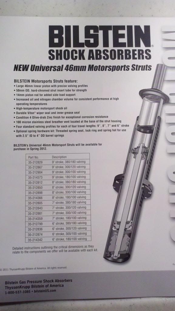

Per Bret at Bilsiten Motorsports the 46mm would be overkill for a tarmac S30 but probably OK for a rally S30.  They are also working on a 36mm version in the same style.  That would be more appropriate for the S30 given the car's weight.
