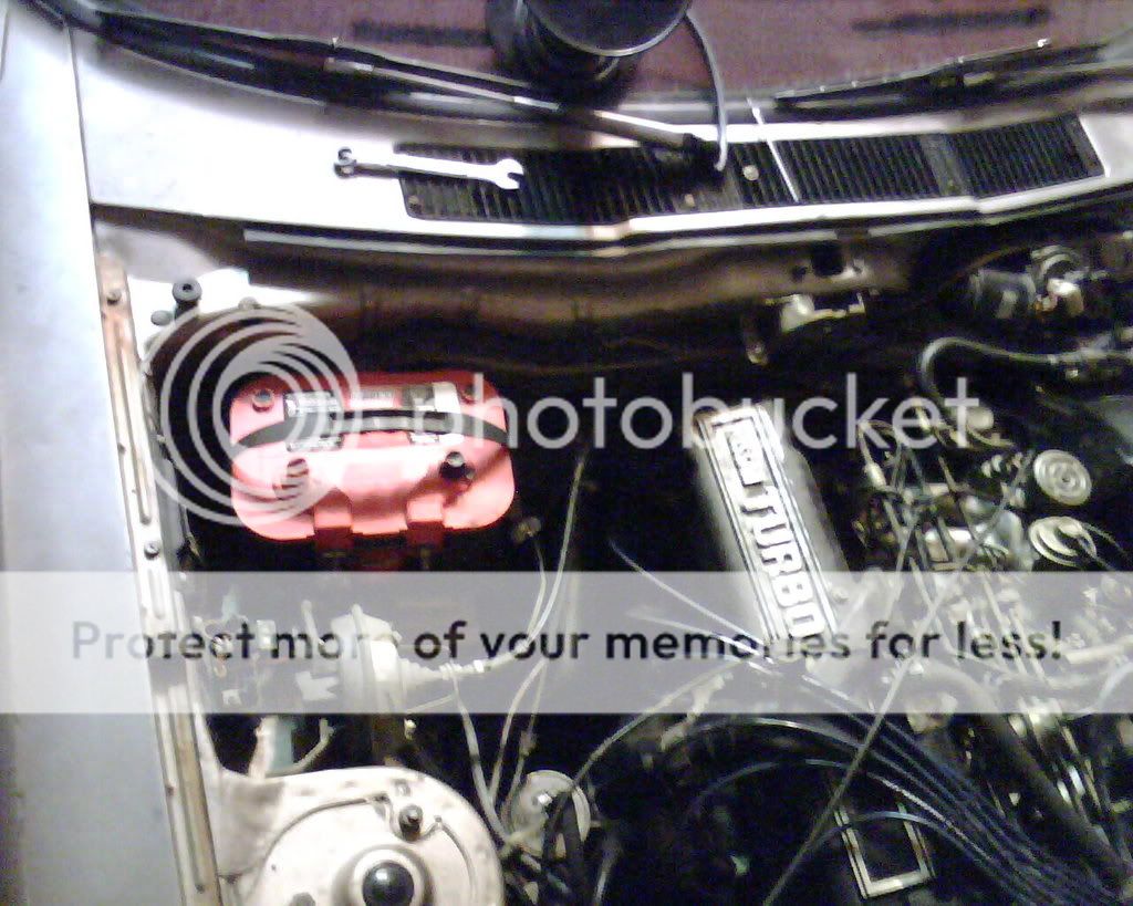

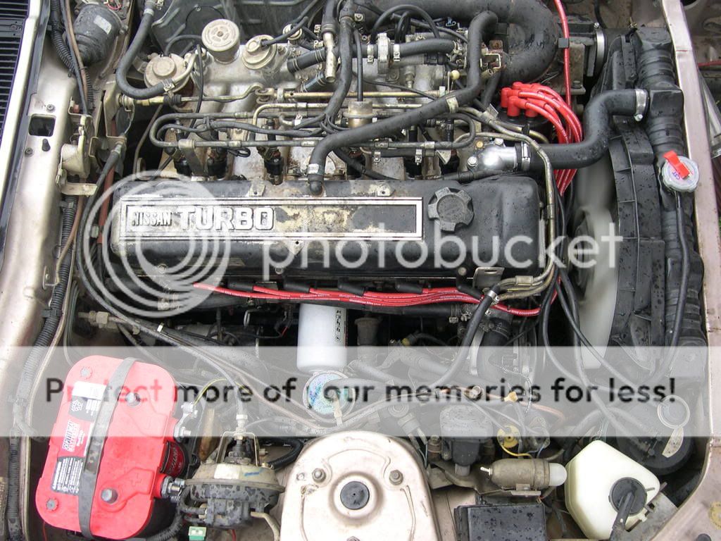

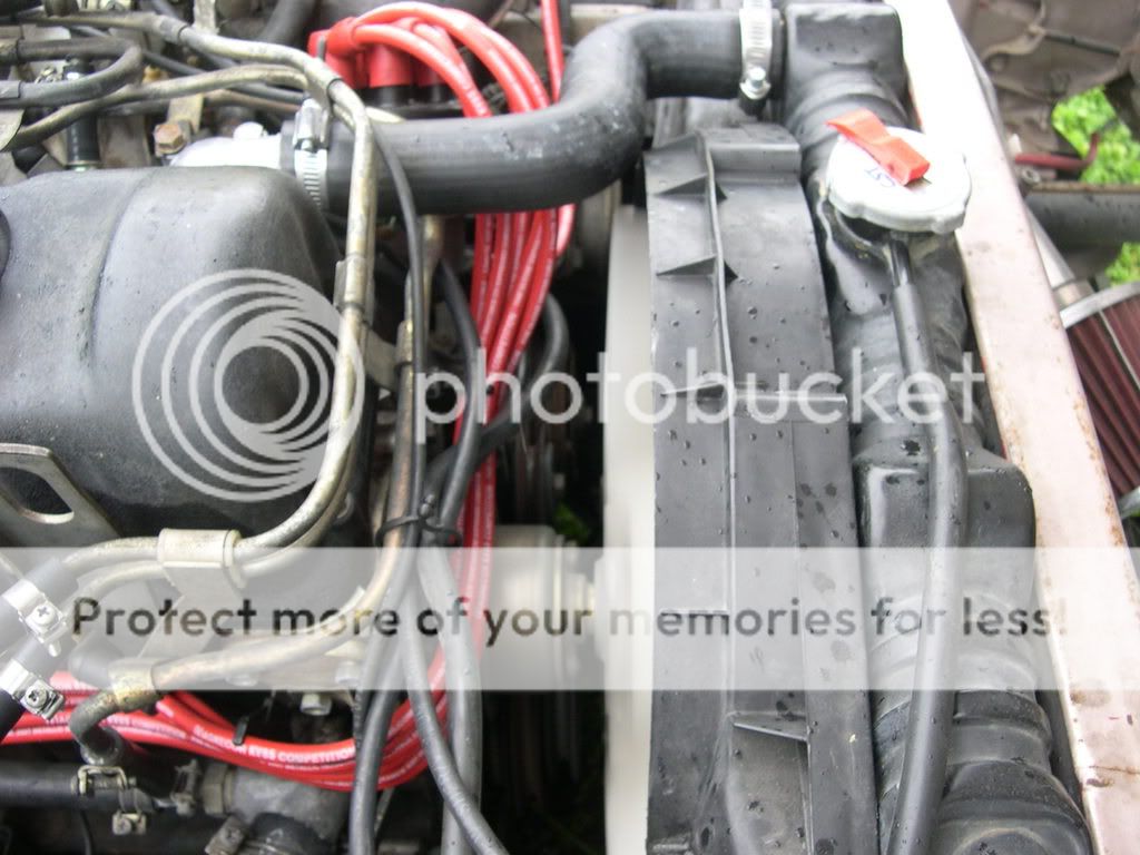

Here is a general shot of the engine bay
What is this thing, EFI relay bypass?

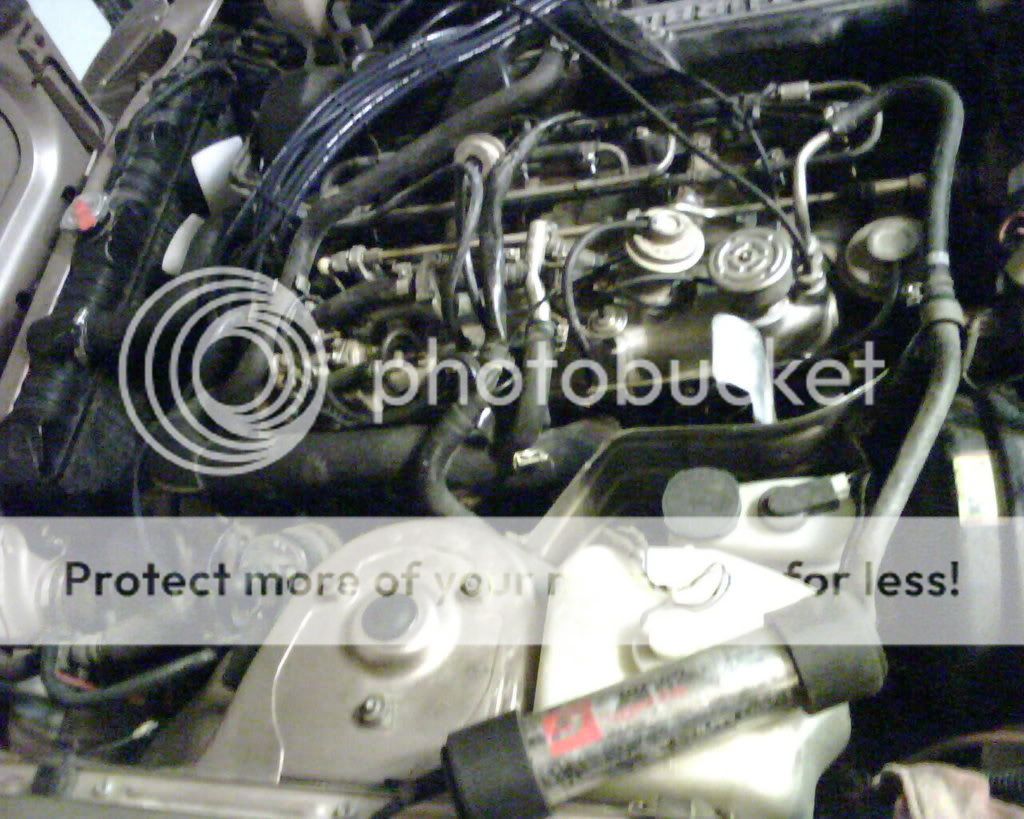

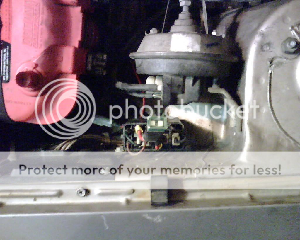

Other side of the engine bay:
That's all I have for now. Progress will be slow, but I will try and keep this post updated.
Thats not a relay bypass. Thats a fuse somebody wired in place of a fusible link. Since fusible links are kinda hard to come by (not sure if they even make them anymore). Shouldnt cause any problems, just would make sure they have the correct amperage for the fuse.

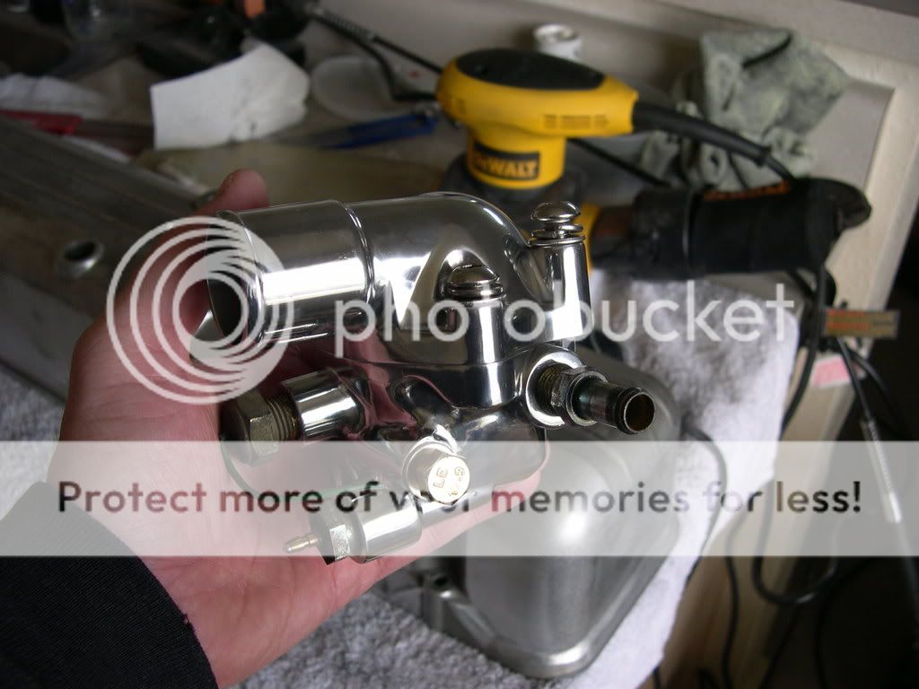

Water cooling neck was pitted so bad I bought a new one off of Ebay. Also got creative and polished the waterneck off of a spare head I had laying around. It's not installed yet.

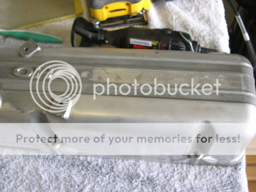

I am polishing another Valvecover as well. So I may have one of them up for sale. This one I am removing the "Nissan * OHC" lettering from the top of the cover and will paint the inlay areas. I am also trying to determine if I weld up the holes for the spark plug wire mounts and then sand flush, will the welded area polish out the same due to a different density/alloy of aluminum. Any ideas on that front?
I am thinking of taking it to a welding shop an having them tig the holes so as to cause the material to melt and fill in the hole, and not actually use any filler material. is that doable, good idea/bad idea?

Filling up the holes with material should be ok on your valve cover 4043 should work just fine.....as far as your concern with wether or not it will polish the same i think you'll be alright. Ive done this to a couple of valve covers that had bad gashes in them, welded them up and polished afterwards and wasn't noticable. Unless you are anodizing the aluminum in which case the welding rod does matter. The only problems ive had with valve covers was grinding off the raised letters and then polishing. I did this to a sr20 valve cover and grinded off the raised letters and sanded smooth and polished and ended up still seeing the letters like ghost paint or something, kinda weird. You shouldn't have to worry about that since your painting over that area but just giving you my experience.And not using filler on aluminum is doable but there is no strength to those areas and will usually crack right away. If your ever near upland area i'd help you with any welding you needed see my sig.

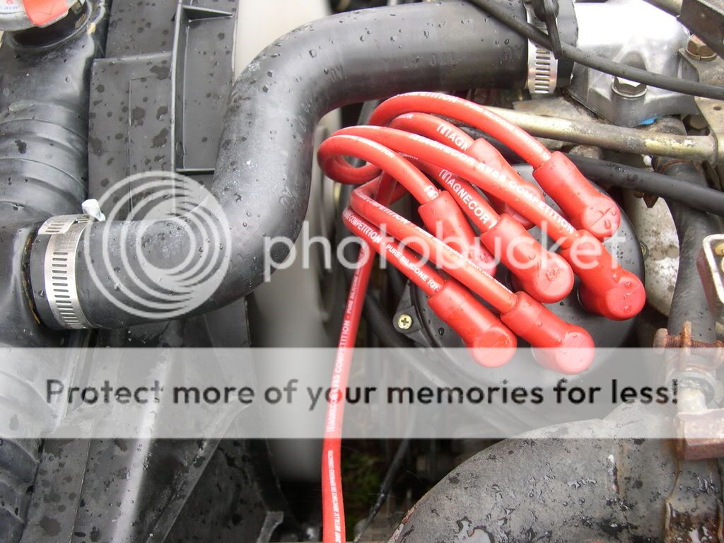

I custom fit those wires, the did not come pre cut. I bought a spool of kv85 magnecor wire (25 feet) and the needed terminals and boots.
concerning the lettering on the cover, I noticed the same when I am sanding the letters. I have not polished them out yet, but from the sanding the aluminum appears to be an inconsistent densitny when I get to the lower layers. It must be part of the casting process.
I have a miller welder with a spool gun. I'll check to see what wire I have. I have tried welding aluminum with the spool gun, and lets just say my skills are not up to par. Do you think MIG is capable of creating a dense enough weld to fill those holes? I have some scrap laying around that I have practiced on, I suppose I will check it out as far as the polishing goes.
(I have lots of ideas, and I learned a long time ago that a million bad ideas that get shot down are ten times better than one good idea that gets shut up)
Idea: grind the entire section deep just a *tiny* bit (what one might call a c^&t hair) too deep with a verrrrrry gradual slope...

that is my plan, when time allows. problem is I am making those cuts with a dremel tool, and it's not really up to the task.
I have the 2 left hand side spark plug wire separator bosses welded in. I boogered it up pretty good with a mig welder and spool gun. I will file it down and report back.

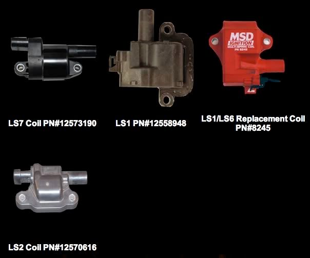

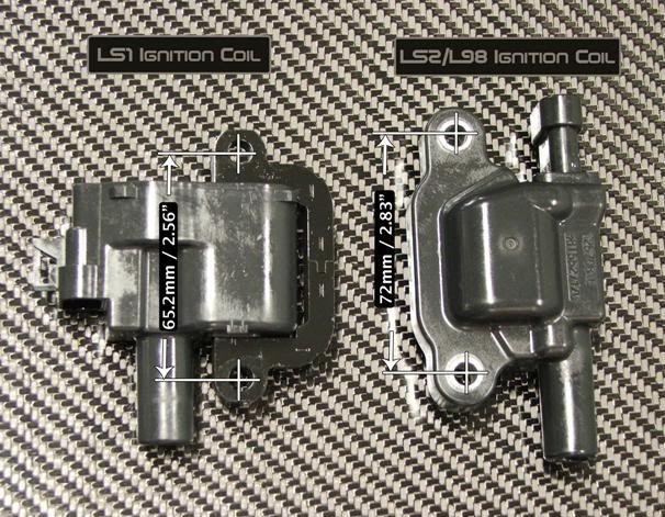

Don't know if this will be of any help to you or not, but I have done a little bit of research on the GM LSx coils, probably not as in depth as I should.
In my GM LSx coil research, there are 2 coils that are the “the” coil choice for radical boost builds and these two coils will outperform both the LS1 AND the LS2 coils! Both are truck/Yukon coils, one of which is what you currently have and are commonly referred to as “the truck coil”. The other is commonly referred to as the “Yukon coil”. As I understand it, both of these truck/Yukon coils will keep lighting the fire in the cylinder of highly boosted engines beyond the point the LS1 and LS2 coils quit igniting the fire. The LS2 coils are a bit hotter than the LS1 coils, but both styles of truck/Yukon coils are still the coil of choice amongst the high end tuners. :wink:
There also seems to be some confusion regarding the LS2 and newer style truck/Yukon coils. In particular is one Mega Squirt ignition tech page that is incorrectly labeling the newer truck/Yukon coil as also an LS2 coil, it is not. See pics below.
LS2 coils are similar in architecture to the LS1 coils with the looped lament core, the newer truck/Yukon coils are round with visible heat sink. When I replaced the 5.3 in my wifes 2001 Suburban, it has the early style truck coils like you have. The replacement ’04 engine had the newer style. I also sourced another set of 8 of these Yukon coils for Ron Tyler, same vintage Yukon 5.3! The LS2 coils do NOT have the visible heat sink. I sent one of these Yukon coils to HBZ member Zya for testing, I think Ron sent Zya an early truck coil a year or so earlier, about the time frame Ron was selling those coil brackets.
http://forums.hybridz.org/showthread.php?t=120533
In the pics below, you can see the difference physically between the LS1, LS2 and Yukon coil;
Here are my Yukon coils, ’04 Yukon 5.3;

So I see there are many physical mounting differences in the coils. I actually got lucky and ordered the right ones for the bracket. I did not realize there were physical mounting differences.
The part number of the coil I am mocking this up with is 12558693 (cast into the plastic shell of the coil) and is for what the ebay page described "2006 - 2000 GM SILVERADO 6.OL 5.3L 4.8L COILS (7) *OEM*"
It appears that the yukon coils are the best from the comments I have read on them. I will look at picking up a set and checking what would need to be done to make a bracket for them. From the pictures they will be more difficult to design a bracket for as they are less symmetrical.

After doing some measurements on the Yukon coil Paul sent me, and the LS1 coils I used, this is my conclusion.
The Yukon coils have a slightly hotter spark than the LS1 coil. So you can probably run a larger gap than the LS1 given equal boost pressure. The Yukon coil has a short charge (dwell) and discharge time. This is good for higher RPM applications in a wasted spark configuration (or if you use just one coil and a distributor). It actually draws slightly less current than the LS1 coil, so it is a more efficient design. It is more compact and has a cool heat sink.

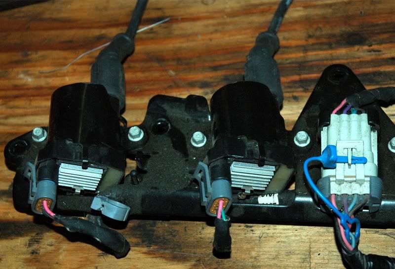

Here is how I mounted my LS1 coils:

I don't have any other photos at this point, and the car is getting some needed bodywork after my Mid-Ohio incident last year, so no more photos for now. This is how I did it. My only suggestion is measure 10 times, and drill once :mrgreen:. Experiment on a junk cover first (that is was I did, but it came out nice so I painted it).
- Coils are centered on the plug holes in the head.
- Holes are 2.25" from the valve cover gasket surface
- Spacers are 3/8 aluminum tubing cut to 1" lengths
- Bolts are 1/4-20 stainless binder head
- A small amount of silicone one each bolt
- Loctite
I used an 8 pin sealed connector (left over from an RB harness), so all you need to do is unbolt the cover, disconnect the 8 pin plug and plug wires and you can lift the valve cover off.
I'm using a Wolf 3D V3 ECU to drive them. Each 5V ignition output drives two LS1 coils in a wasted spark configuration. A Megasquirt can also drive LS1 coils in this arrangement.
