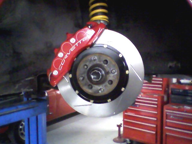

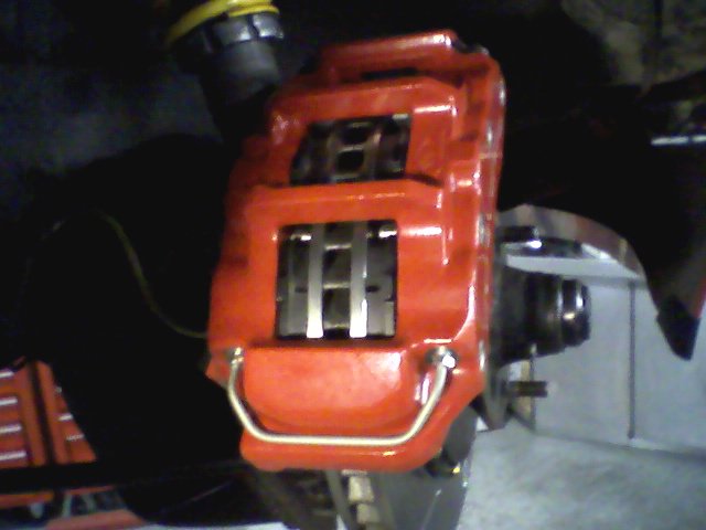

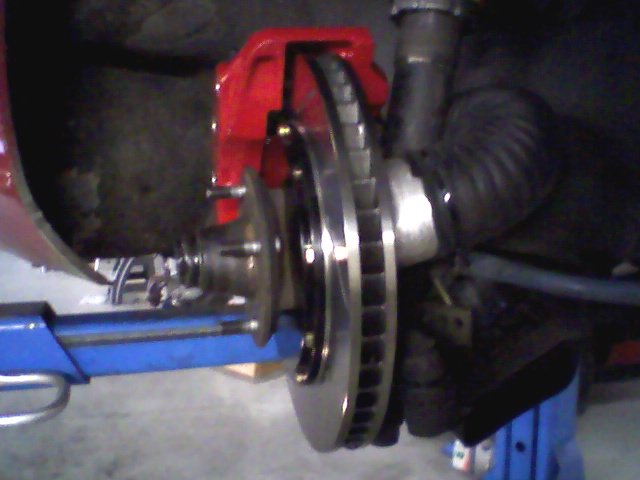

Hi Guys, I installed a set on my car earlier this year, very happy with the result. Also using Stoptech 330mm Aerorotors and Racebrake ET800 pads. Excuse the quality of the pics (mobile phone).
how did u mount these up? are you using the z06 in the rear also?
Had some custom adaptors fabricated out of aluminium, not an easy task.
the installation is very tight.
My rear brakes are 286 by 25mm vented rotors with a sliding piston caliper, they are off a locally produced Ford with competition pads and ducting for cooling.
they are holding up OK for now, maybe at a later date I will upgrade to the 4 piston rears.
Higher priority is to upgrade my turbos to some new Garretts.
