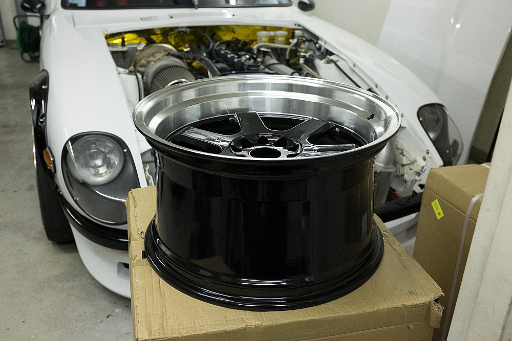

New trackday wheels 18x10 ET0
TSCF3247.jpg?m=1450550271

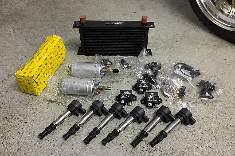

More fuel pumps, BMW E92 M3 coils, fuel cooler..

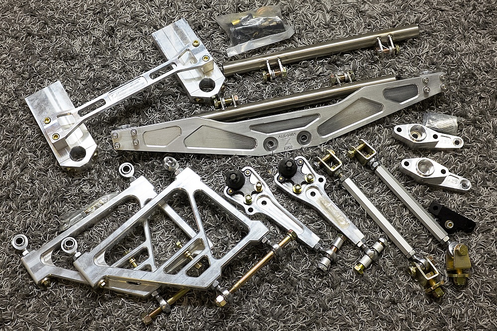

Arizona Z Car billet suspension parts
TSCF3370.jpg?m=1453316074

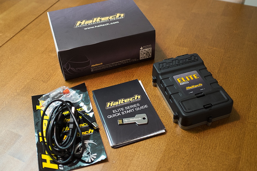

Haltech Elite 2500 ECU
TSCF3385.jpg?m=1455122349

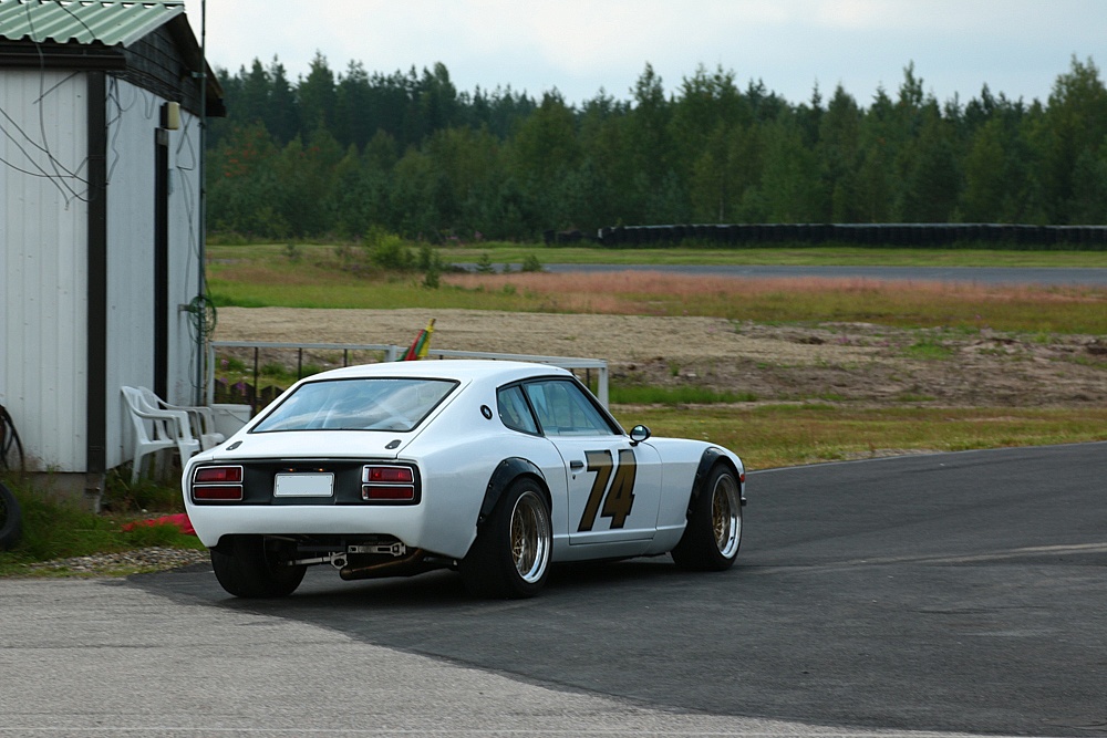

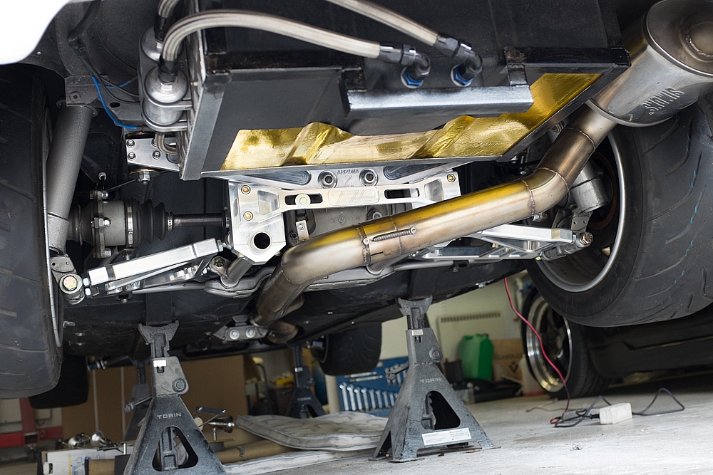

I was too busy (or lazy) in winter but finally installed most of new parts. Engine is now running with Haltech Elite, and runs smooth with new BMW E92 M3 Coils. I changed boost controller from (3-way) to 4-way Mac-valve.
All billet suspension parts are in place. I started to create blade-style swaybars, but didn´t finish those, so continued this summer with stock ones. First setup was -2.5 camber in front and -1.3 in rear.
TSCF4368.jpg?m=1464953419TSCF4371.jpg?m=1464953409
TSCF4372.jpg?m=1464953419

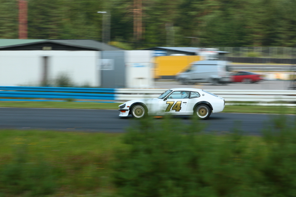

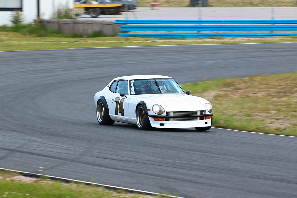

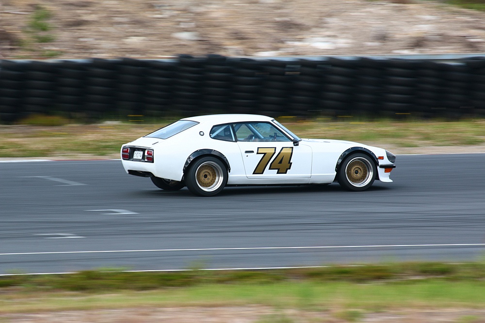

First trackday with new parts:
I started with (rising) low boost-settings and didn´t have any problem with traction. Problems came when I tried braking from high speed. I will need much bigger brakes with better brake pads (Probably Alcon calipers / Ferodo pads / 330mm disc all corners).
Handling was pretty good, but I´m going to try those new swaybars and stiffer springs.
TSCF4377.jpg?m=1470161601TSCF4376.jpg?m=1470161592
TSCF4374.jpg?m=1470161584TSCF4378.jpg?m=1470161592
Short video, I beated my previous 350Z lap record with awful driving :)

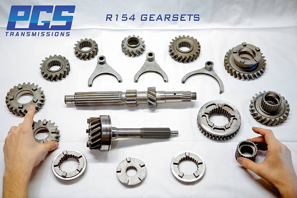

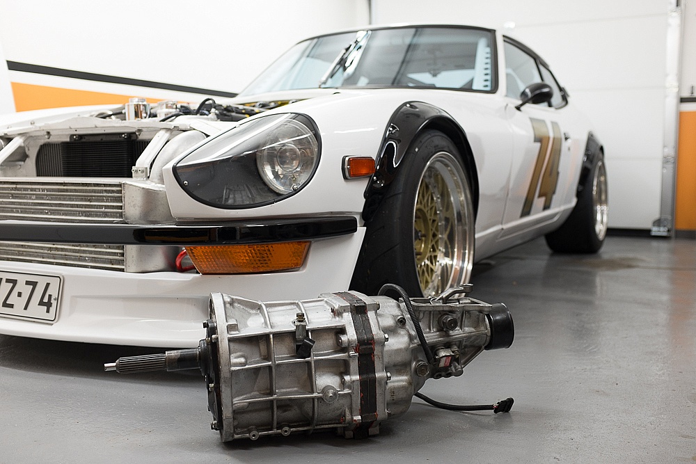

Yesterday I got new transmission. PGS Transmissions R154 with dog engagement gearset.
TSCF4809.jpg?m=1479405721
TSCF4796.jpg?m=1479405719

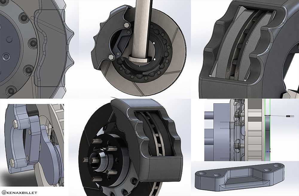

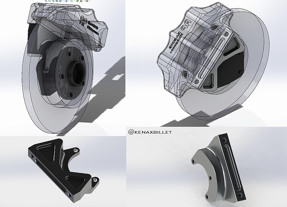

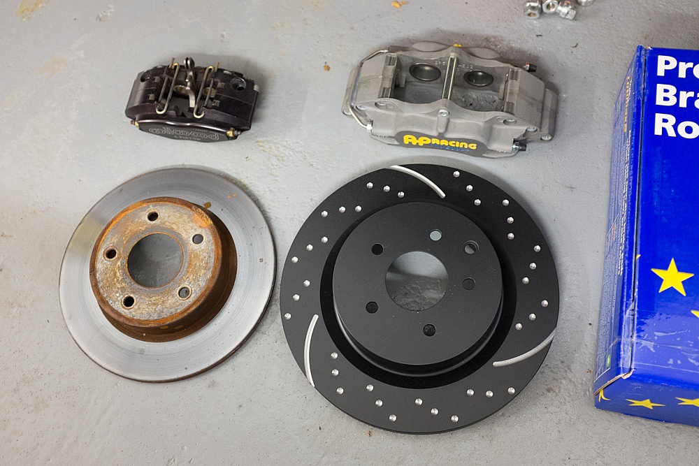

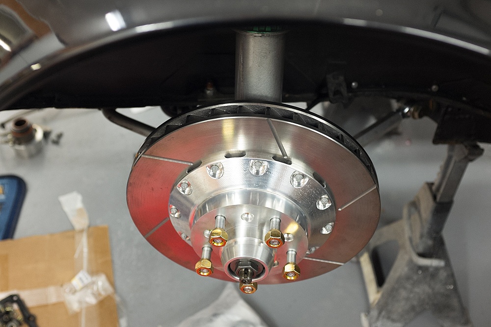

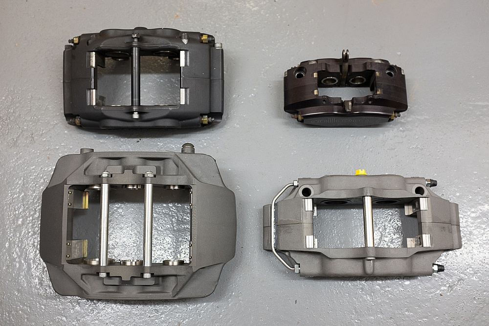

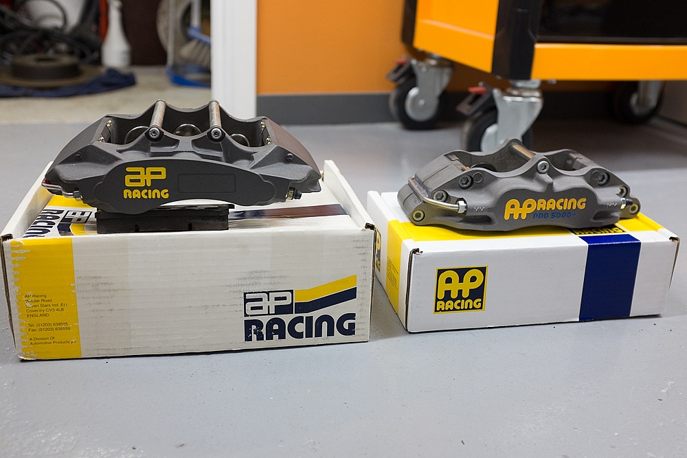

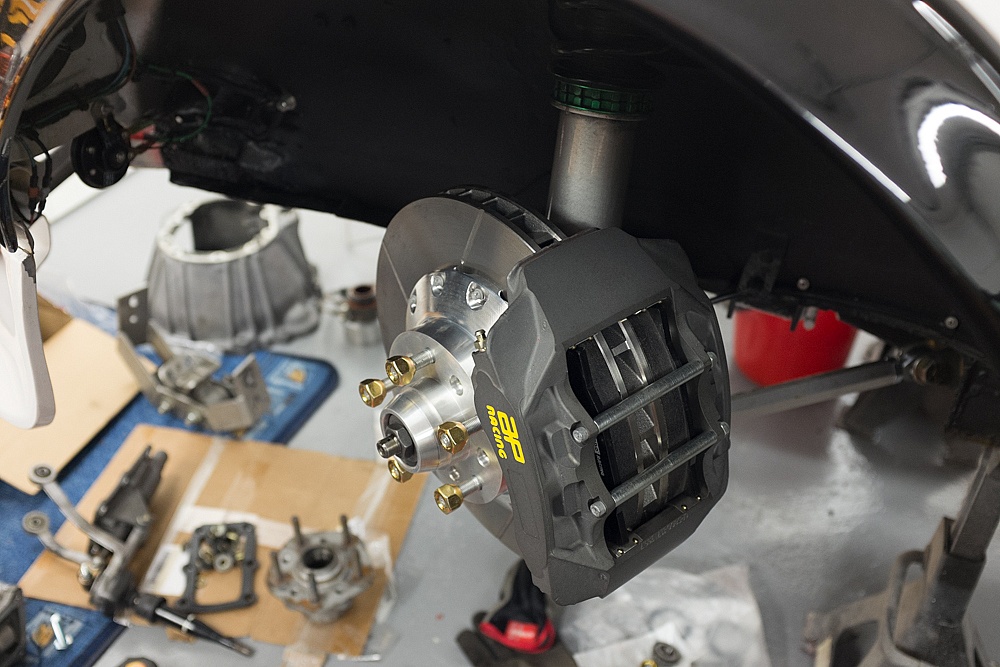

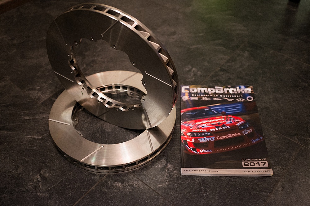

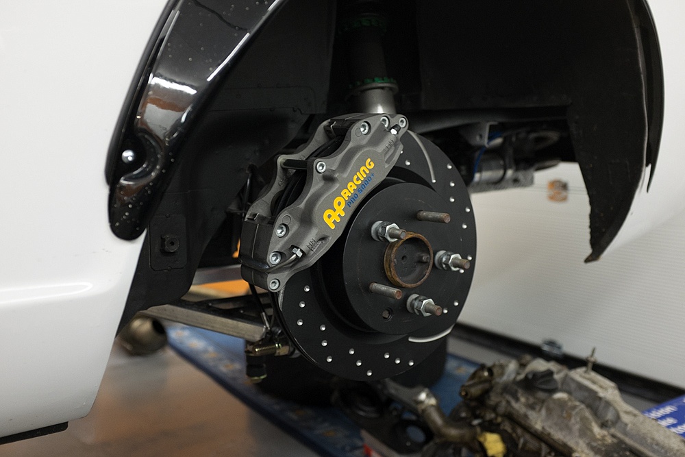

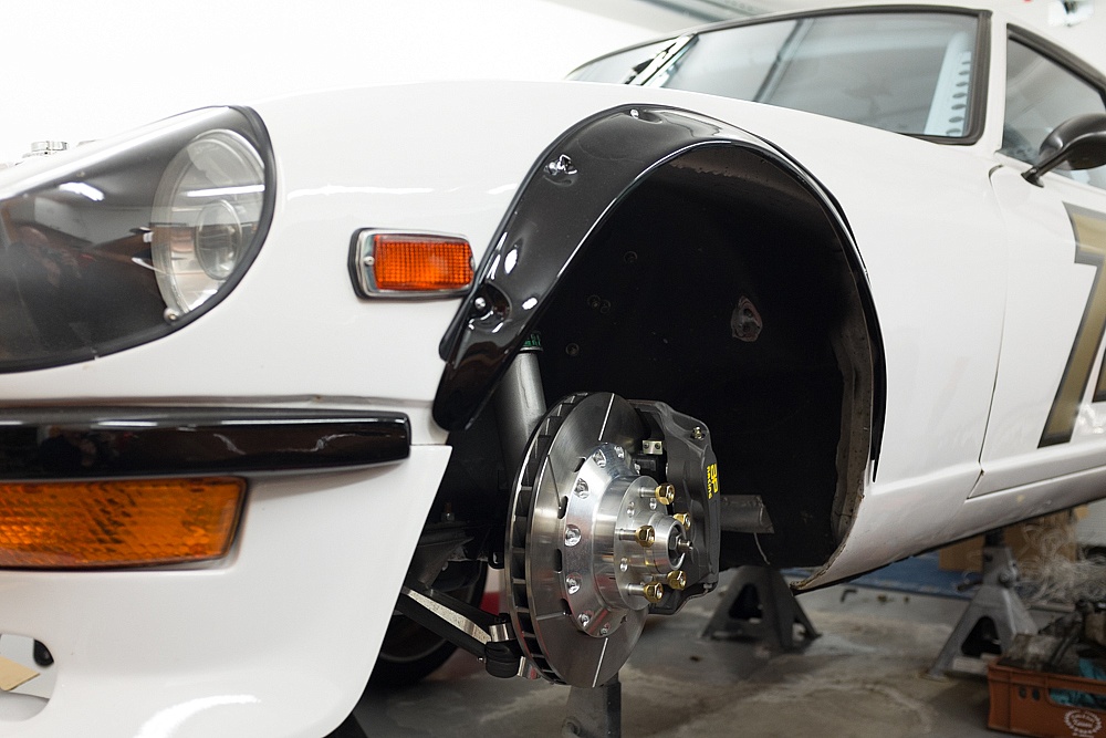

Brake upgrade coming with high quality parts.
New AP Racing 6-pot and 4pot calipers. Both calipers designed for ~330mm discs.
Front disc 335x32mm Compbrake
Rear disc 322x22mm EBC Turbo Groove (350Z Rear Brembo)

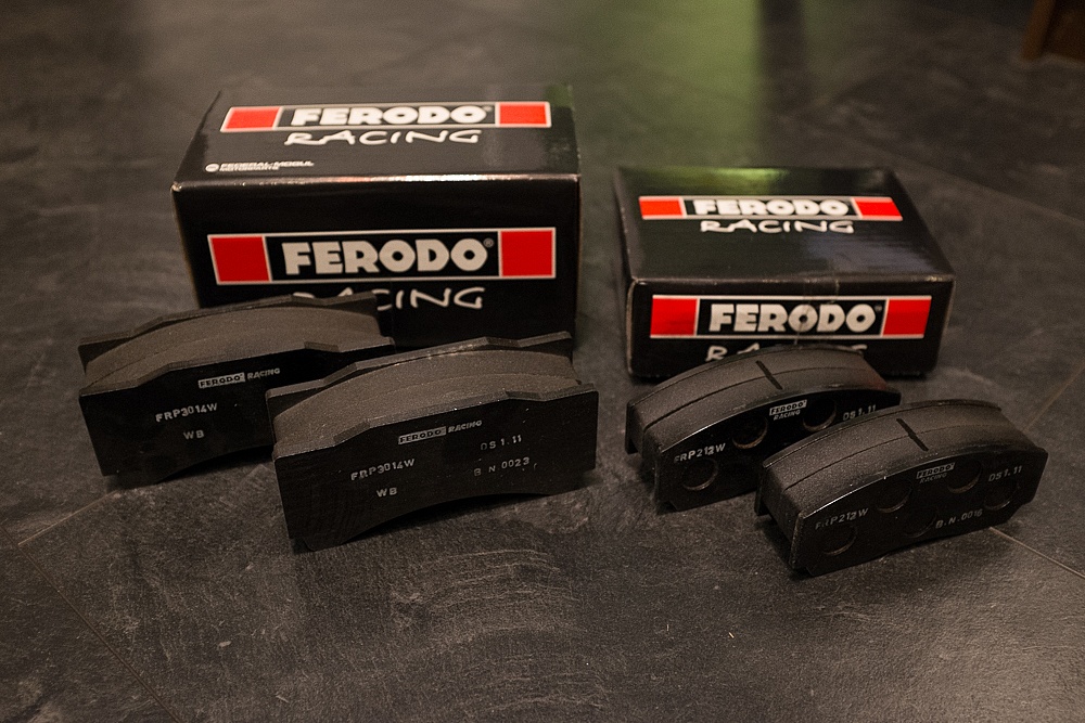

Ferodo Ds1.11 Pads all corners

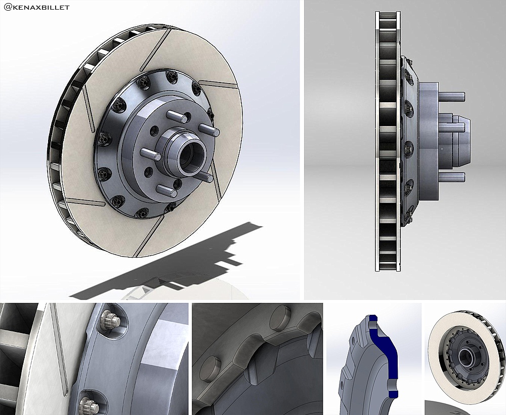

New billet adapters and disc bells. Design by Kenax Billet (my friends company)
New Tilton master cylinders for Tilton pedalbox. Bore size calculated by Tilton.

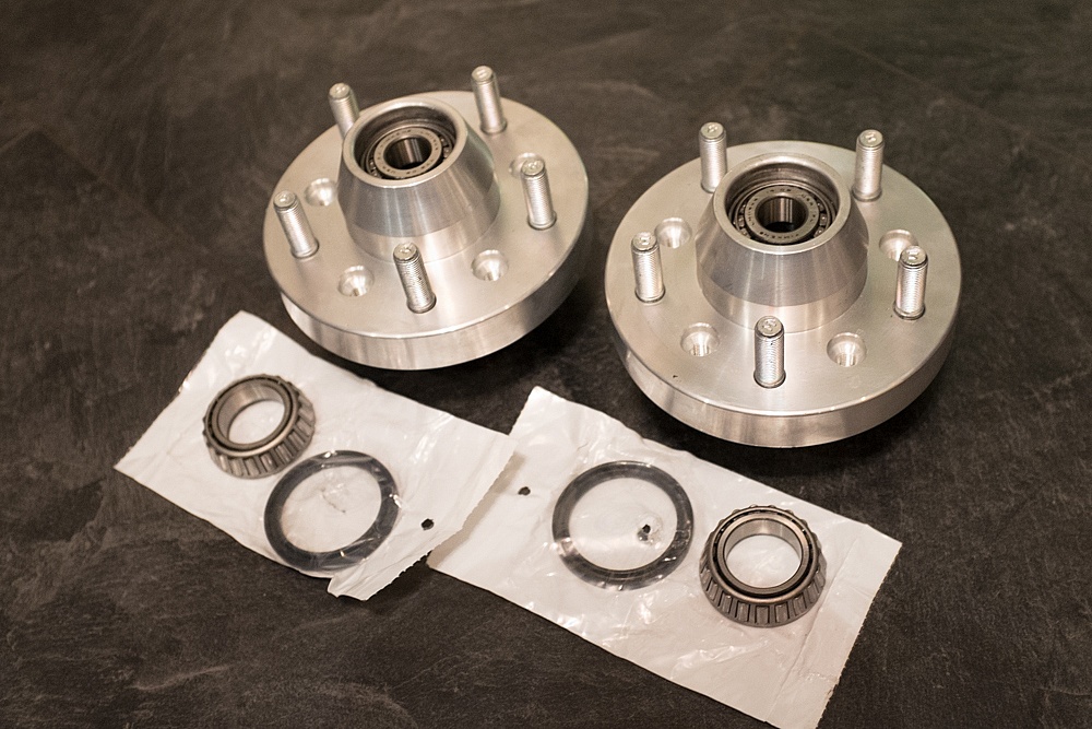

Billet front hubs
TSCF4811.jpg?m=1482873464TSCF4813.jpg?m=1482873476
TSCF4851.jpg?m=1483558911TSCF4857.jpg?m=1484254397
TSCF4858.jpg?m=1484509305TSCF4862.jpg?m=1485288609
TSCF4868.jpg?m=1485288580TSCF4882.jpg?m=1485288609
TSCF4861.jpg?m=1485288580TSCF4860.jpg?m=1485113048

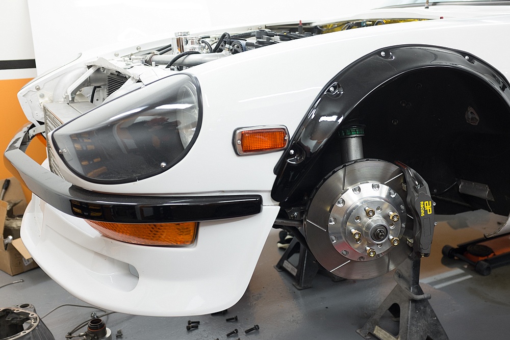

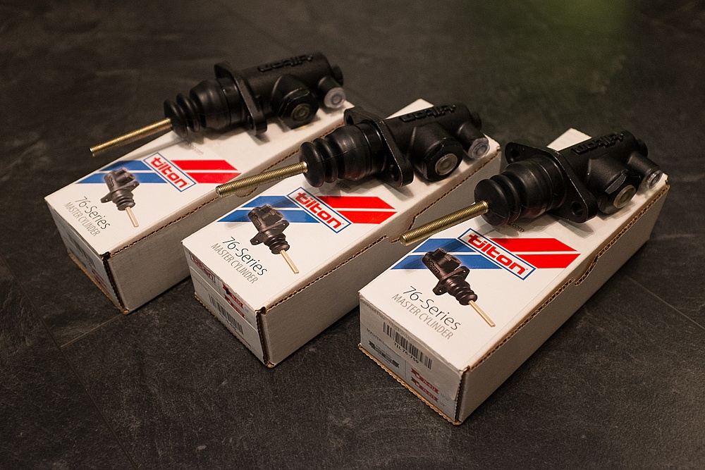

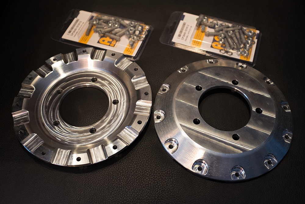

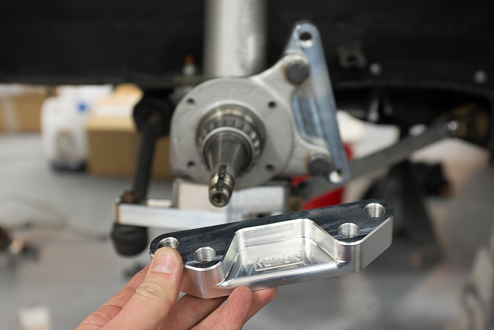

Brake upgrade continues. New Tilton master cylinders and Ferodo DS1.11 pads.
TSCF4890.jpg?m=1486413711TSCF4892.jpg?m=1486413711

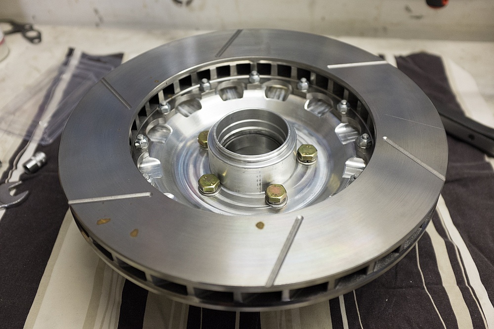

Billet front disc bell´s by Kenax Billet with AP-racing bolts. High-class service! Company doesn´t have website at the moment but you can find from instagram @kenaxbillet
TSCF4894.jpg?m=1486574305TSCF4896.jpg?m=1486574307
TSCF4904.jpg?m=1486574310

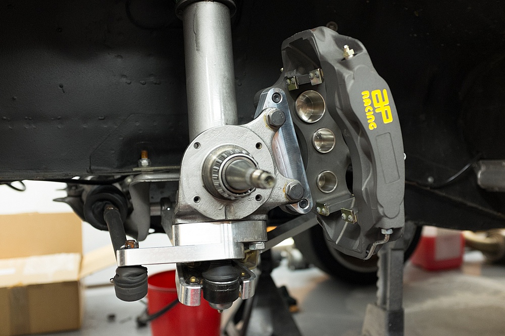

Test fitting front caliper. Now it needs new bracket and setup is ready. Also need to change from caliper bleed screws up and hard pipe down.
TSCF4907.jpg?m=1486583959

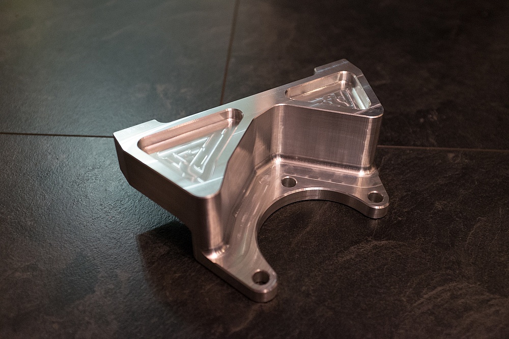

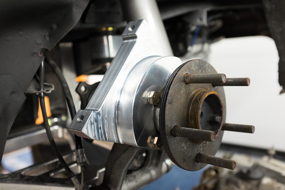

Last billet adapter part for brakes is ready, and everything looks good!
TSCF4908.jpg?m=1487707226TSCF4957.jpg?m=1490037749
TSCF4960.jpg?m=1490037742TSCF4966.jpg?m=1490037750
TSCF4976.jpg?m=1490037742

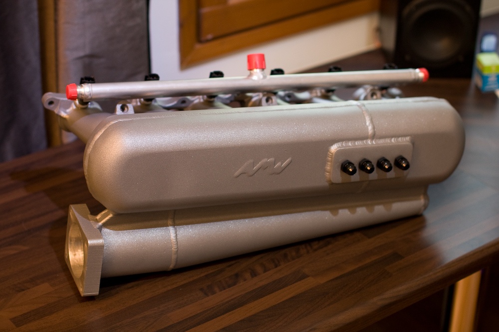

Bye the way all your older pictures are broken and can not be seen. I'm curious as to what intake manifold you are using as I am slowly building up a 2JZGTE.

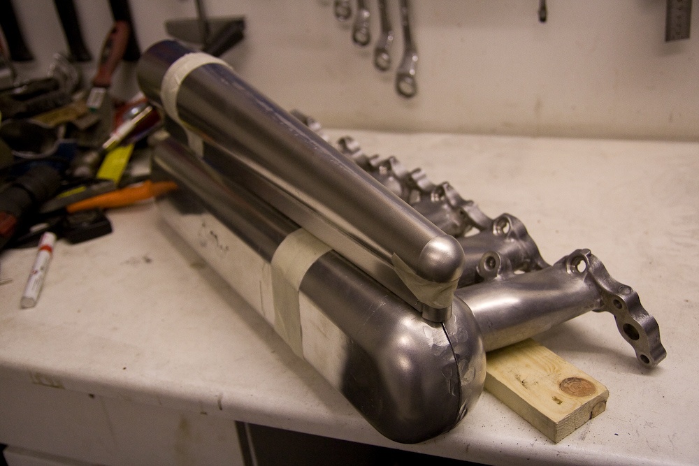

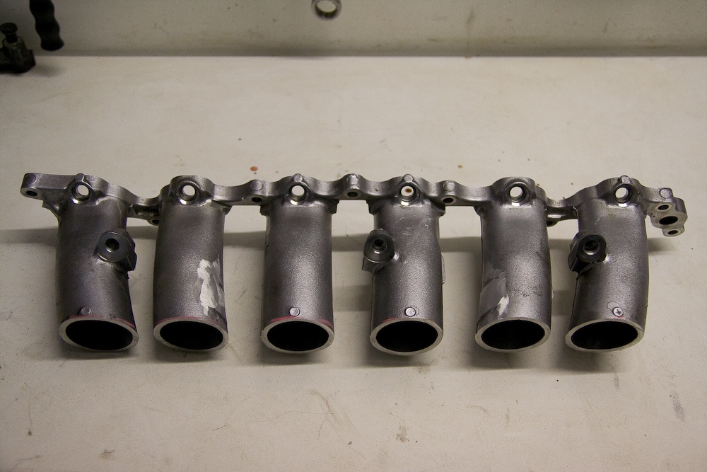

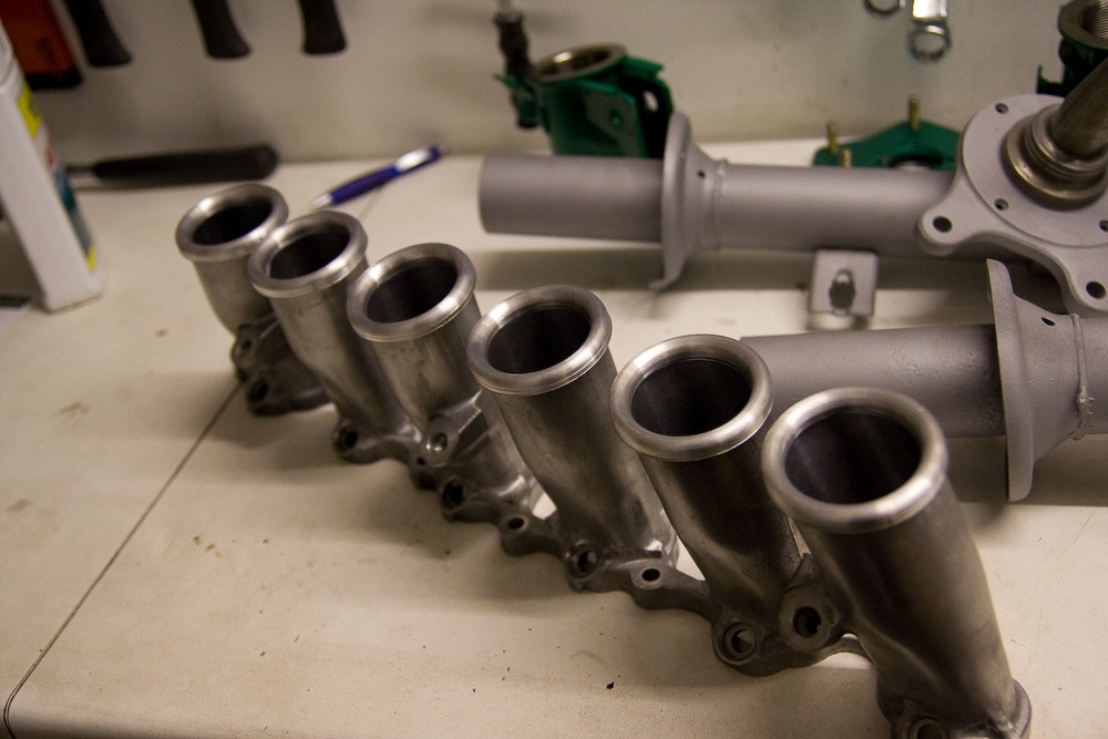

Yes old links are broken, but you can find all my old images in my picture gallery. http://260z.net
I´m using custom made dual plenum intake manifold.
gIMG_4070.jpg?m=1283802962gIMG_4154.jpg?m=1283802988
gIMG_4100.jpg?m=1283802972QMG_8717.jpg?m=1315659343
